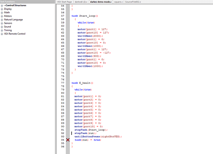

hello, im trying to set up a haulting code for an emergency stop protocol but i keep getting an error message. i need help with this
please help asap

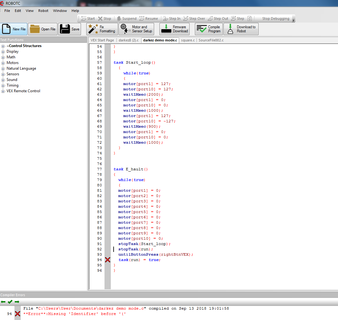

It wants an identifier for the task it was expecting you to define. The ‘task’ keyword is only used when you are about to define a new task. I think you want to say
StartTask(run);
here instead.
