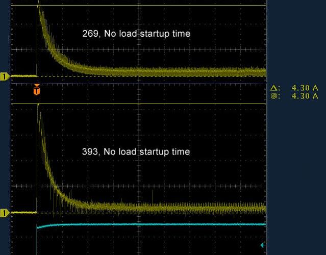

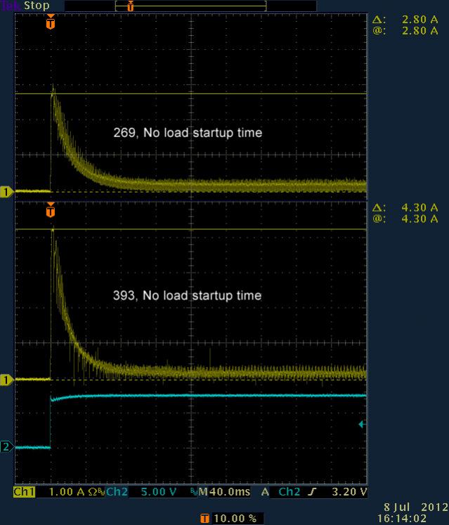

I’m still not convinced on the different startup times. Under no load they are the same, I will try and find a way to test under load but its not so easy.
This composite trace shows startup time for the two motors, both reach full speed in approximately 100mS. The 269 may be slightly slower but I doubt you would notice the difference.
Under load this may not be true, TBD.

Ideas:
Chaining/gearing a powered motor to an unpowered motor might be a way of providing a standard load. A string drum with a weighted string, with string starting taut might be another; its more clunky to manage, but has a specific torque value.
Gear 3 motors together, and power 2 of them from a Y cable (to ensure the same power applied), and check your same type of current profile might show if they are dragging each other.
Gear 3 motors together, and power 2 of them from independent motor ports;
the same types of current profiles may vary depending on the programming gap.
Several iterations might hit once on the maximum program gap (5 vs 40ms?) and show that a 40ms gap vs a 100ms ramp is significant (or not).
Predictions: what would drag look like?
  • P1: A motor with a load will have a slower curve to minimum current.
  • P2: A motor being dragged ahead will have a faster curve.
  • P3: A motor dragging another motor in addition the the load will have a slower curve.
