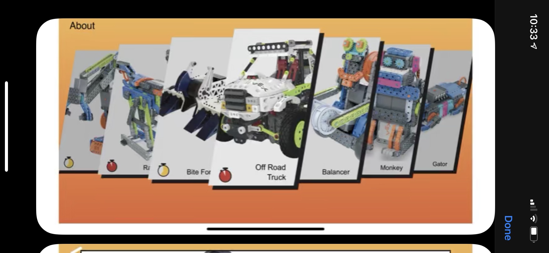

I am wondering why the Vex Pilot mobile app for iOS and Android does not allow you to control a robot using the VRC brain?
Why is this not supported in the app? Does anyone have suggestions for how I could build a version of this app that can remotely control a robot using a VRC brain?
It is only for these kits:
You cannot control your robot simply with just a device (like an iPad or android).
