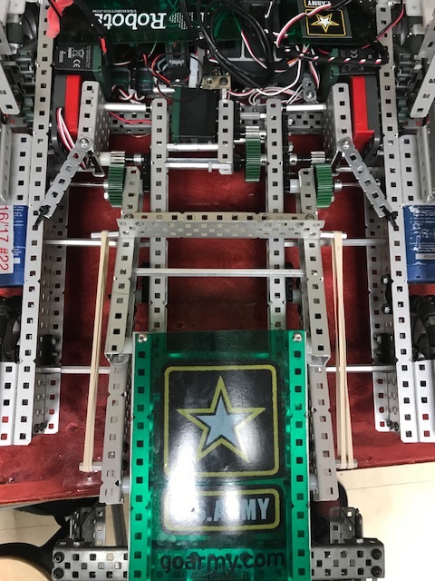

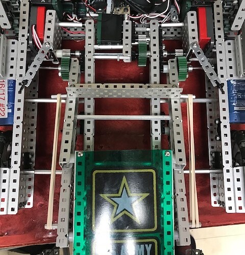

We use a 4 bar like most teams with a 1 motor 1:9 gear reduction which works great on conserving motors for different parts of your robot.
DID
YOU
SAY
1:9
I was confused by that to. I though it could only get to 1:7
Compound gear ratios. If you look at their image, you see two 1:3 reductions.
