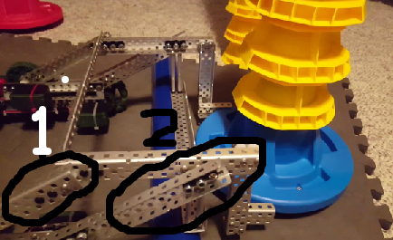

@Baguette123 The first lift I built was the one from the video; the chassis ended up being too long for the first one, so I made it smaller and the lift seems to work in theory. When I lift the mechanism up, it stays, but pivots on the lock nut I put on there so it rotates down. How do I fix this? (I haven’t built the other two yet because of lack of parts)
Photos would help
Rubber bands. But if that doesn’t work, a picture would be helpful.
@Baguette123 @Easton Hopefully this helps!
From what I can see, you don’t have a 4-bar. In a four bar, the top of your mobile goal intake is connected by two bars to the chassis.
From this picture of a 4-bar intake. You have the bar marked 1, but you need the bar marked 2, as you have nothing supporting the other side of the intake. This is the purpost of a 4-bar. Hope this is correct!
Correct, a 4-bar needs literally 4 bars to function correctly
@Easton @Baguette123 yeah, that was pretty stupid on my part. I didn’t have any more c-channels of that size and I kind of hoped for the best. I put two more on (I had to cut a few parts), but now I’m confused as to how I’m going to get the bars to turn with the motors. From what I could (technically, couldn’t) see in the video, there weren’t any gears but I highly doubt that can happen without gears.
