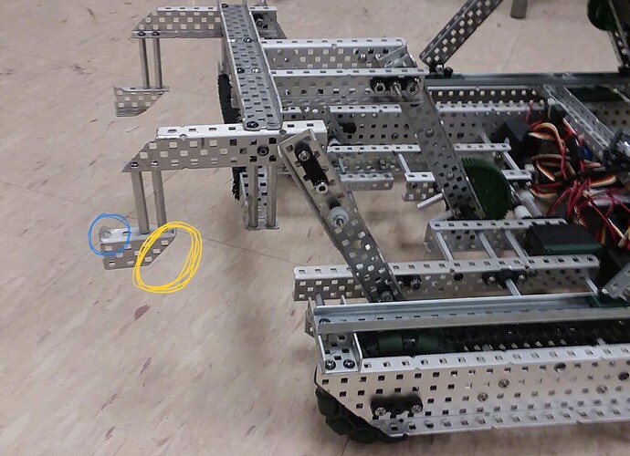

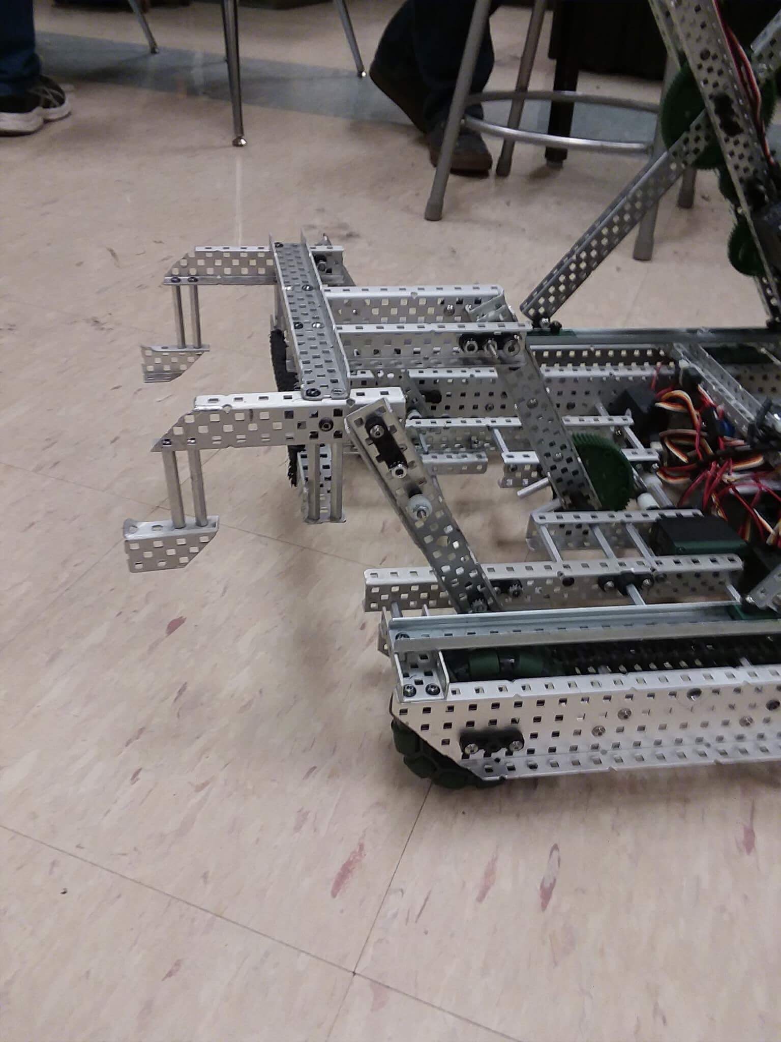

This is an older version of our 1:7 mogo intake
@TheLordsChipsBuilder I have a question why do you have pieces of metal cutted on a angle? And why is the piece that supposed to pick up the mobile goal bented upwards? Just curious
I think it’s bent not bented
Sorry was on my phone
The part that is bent upwards helps guide the goal into place and the part cut at an angle helps release in the 20 point Zone
That’s what it does.
