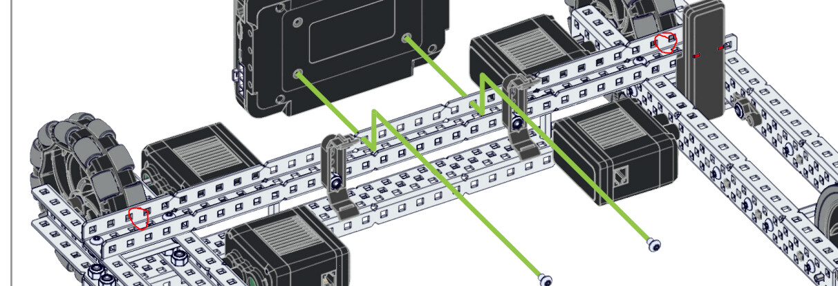

Does anyone have the measurements required for setting up the moby drivetrain in vexcode?

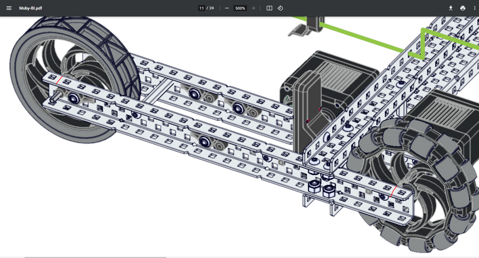

Looking at the Moby instructions: Moby PDF
There are 24 holes between the front and back wheels which is 12 inch wheel base.
And 30 (maybe 32) holes from left to right for a 15 (or 15.5) inch Track Width.
