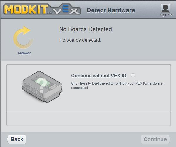

I am having a frustrating time with modkit. I followed your video exactly. When I download the program, it tells me error programming. It doesn’t tell me anything else, so I don’t know where the error exists. Anyone else having problems?
jgillespie,
I have had this happen a few times and this is what I have found that causes/fixes the problem…
  1. Are you on a schools computer? Do your account settings let the driver install when the USB is plugged in? (use the same USB port every time)
  2. Are you running modkit link?
  3. If you open modkit and continue without the brain plugged in do the programming then later plug in the brain to download you will get an error. (you will need to close the explorer window and restart)
  4. I have had problems with my schools laptops that run XP but no problems with windows 7 computers
  5. Motors in robot view ports are not all selected or sometimes the plugs on the brain on robot view disappear and you need to re-assign the ports to the motors in robot view you make this re-appear.
Bart
Bart,
  1. I am on my personal laptop, which is running windows 7, and I use chrome.
  2. Yes
  3. The brain is plugged in, and modkit sees it when it loads up
  4. Everything seems fine in the program
I really wish it actually said more than “error programming”
I have tried restarting my browser and computer multiple times too.
Thanks,
James
Can you download any projects? Try creating a simple program that when started it prints hello on the screen and see if you can download it. (see attached picture)
  1. Project->New Project
  2. Block view
  3. When Start.-> print hello
Check to see if you can down load that, when you run this it should print hello on the screen, if it will not download I have no idea…
I understand your pain that it does not tell you what the error is, it just says error…
Bart
