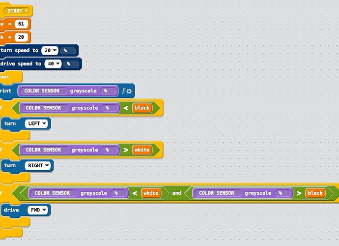

Yes, this is definitely possible. Attached is a rough idea of what you need to do. Make sure the colour sensor is set to greyscale mode. In Modkit, this basically returns a percentage value where 100 is white and 0 is black. In practice, your values won’t go right the way to 0 or 100.
The program tracks the right hand edge of the line - if the percentage value is greater than the white threshold, it has strayed too far off the line into the white and so the robot turns left. If the percentage is less than the black threshold, it has gone too far over the black line and needs to turn right. If the percentage is between the two thresholds, the robot is half on the line and half off it (following the edge) and so can go straight forward.

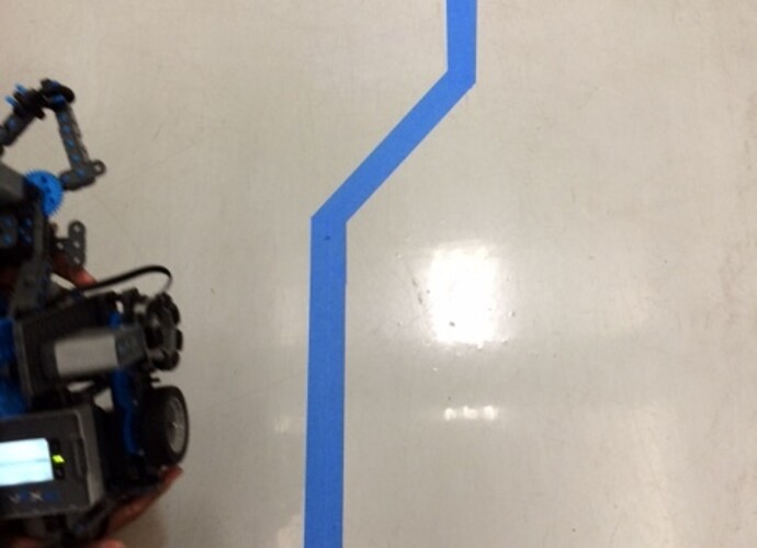

Thanks for the help! It works fine when turning to the right, but loses its way when the line turns to the left. Suggestions?
Is it working in principle? i.e on my robots, this program will linetrack the right hand edge of the line. Therefore if you put the robot all on the white, it should turn left. If you put the robot on something black, it should turn right.
I notice your line is blue, this will have a higher threshold to the black lines of the IQ field that I used to test so I guess it won’t see the blue line as black.
To calibrate it, you can expand the program. under the brain, make a when start and then a foever loop. Inside the forever loop, print the colour sensor % to the screen, add a 0.2 second wait and then clear the screen. When you put the robot on the line, you can see what value is your “dark” and calibrate the black threshold a few % higher than this value.
Hope this helps!

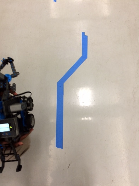

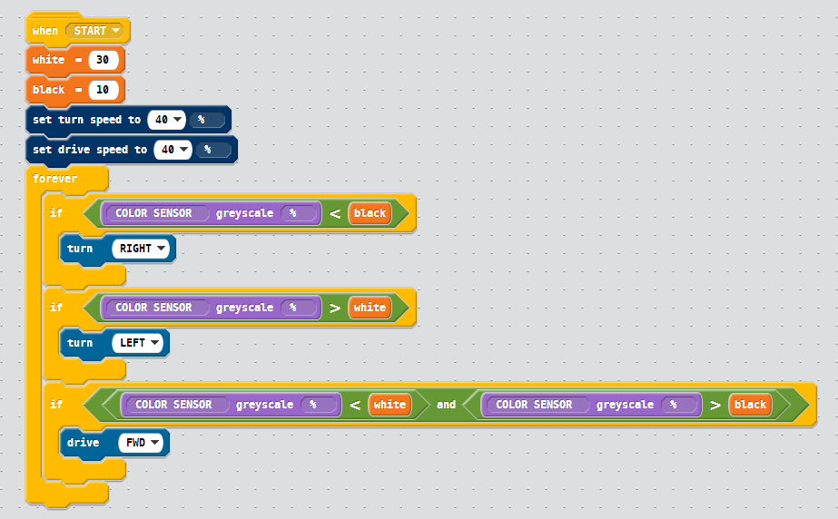

Here’s our code and a video of its behavior.
OK, makes sense. What is happening is that the robot is detecting the white just fine, the white areas are massive so it has plenty of time to do this. However, it moves very quickly over the blue line and back onto the white the other side, which makes your robot think it has fallen off the left of the line and therefore turn right.
Couple of things you can do here.
  1. use a black line instead of blue so that the contrast between light and dark is greater
  2. double the thickness of the black line so that the robot has more time to detect it as it sweeps over the line
  3. slow the robot down a bit
  4. “calibrate” the threshold for the line using the technique in my previous post if you have not already done so
