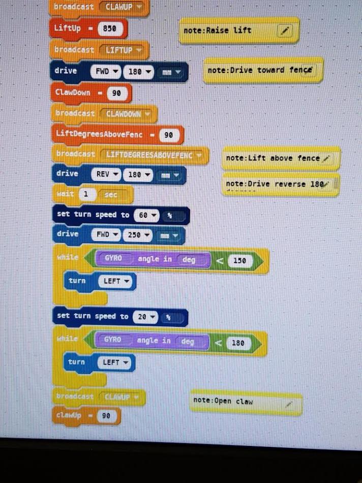

Can you please post the code with the “unheard” broadcast?

Here’s the code. Pretty straight forward.

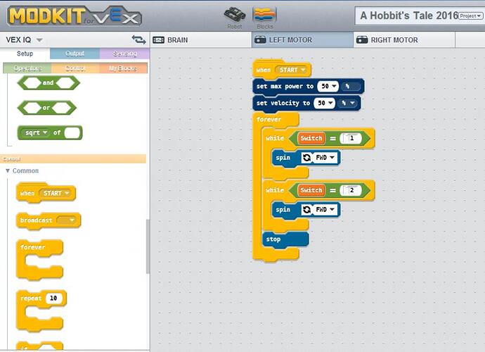

To create a variable:
Click on “New Variable” in the block list. [see photo 1]

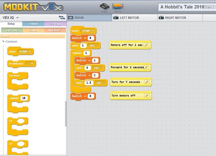

On to the code examples... [see photos 3-5]
First I assign the variable and have it change after a specific period of time. [brain code]

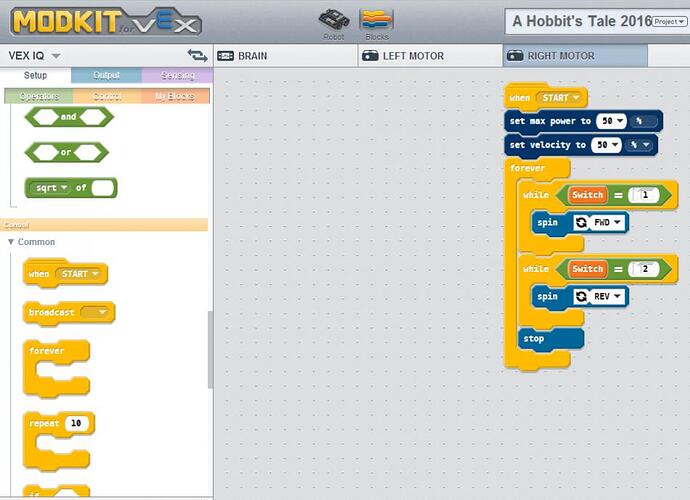

Note that the left motor always turns forward… [left motor code]
…while the right motor reverses direction whenever the variable is equal to 2. [right motor code]
SO… When the motors are both turning forward (switch = 1), the bot goes straight forward. When the motors are turning in opposite directions (switch = 2), the bot turns in place. When switch is 0, the motors stop.
In addition to using time intervals, variables can also be set / reset whenever a button is pressed on the remote, when a bump switch is touched (for example, when the claw is lowered all the way down), a task is completed, the color sensor value detects red for color OR is equal or greater to a certain number using the ambient light setting, and on and on! The numeric value for the variable can also be used in mathematical operations: [variable = variable +1, for example], or logic statements: [IF variable is >5…, ELSE…]
I think you will find many uses for variables, and the BEST part is that you only have to set them in ONE line of code to simultaneously affect multiple motors or logic statements throughout your entire code.

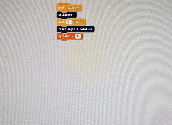

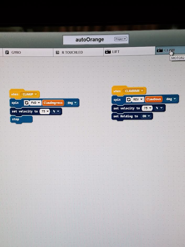

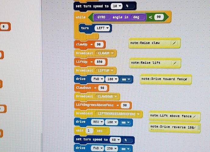

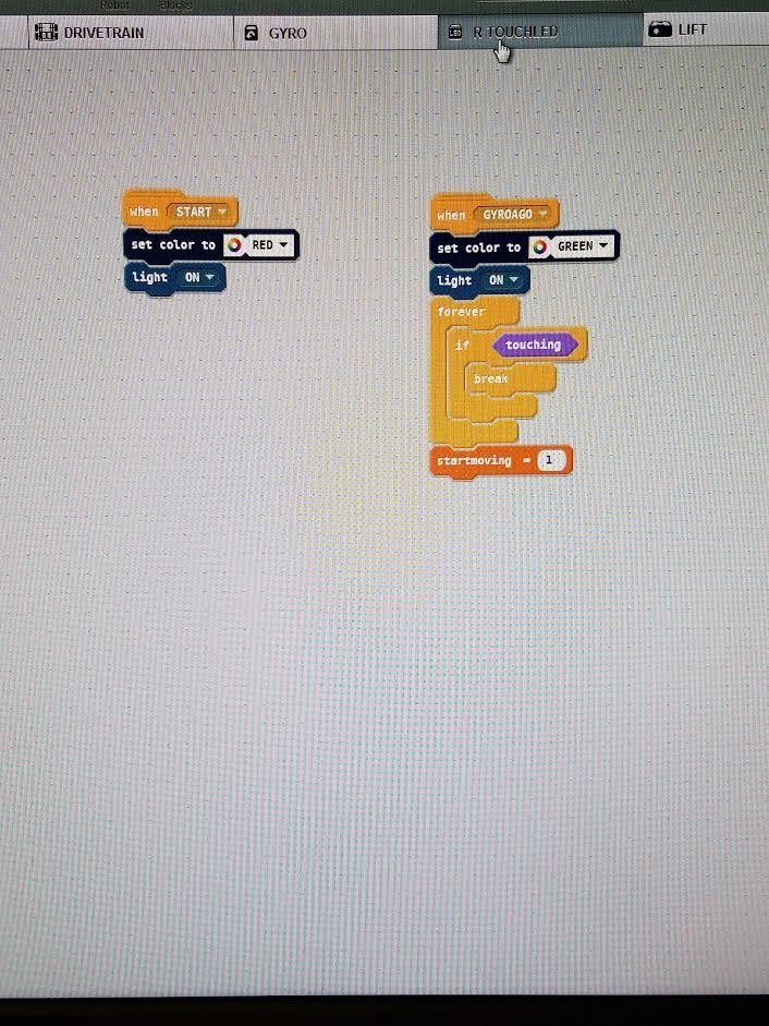

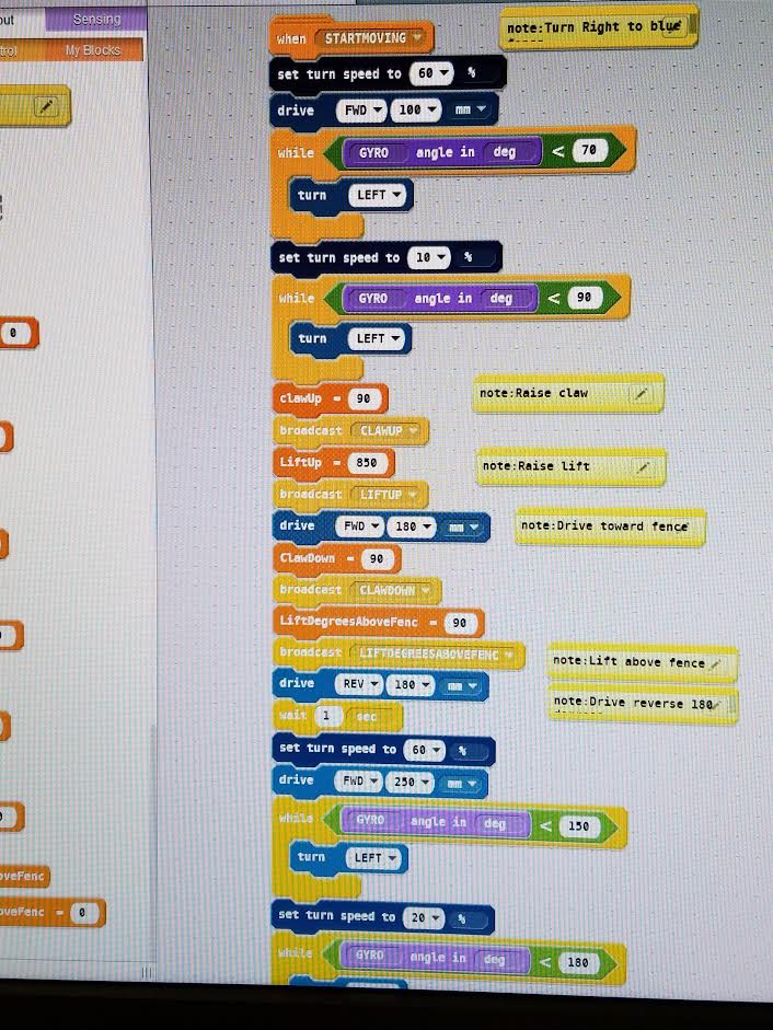

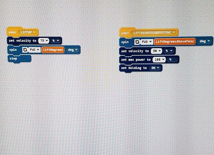

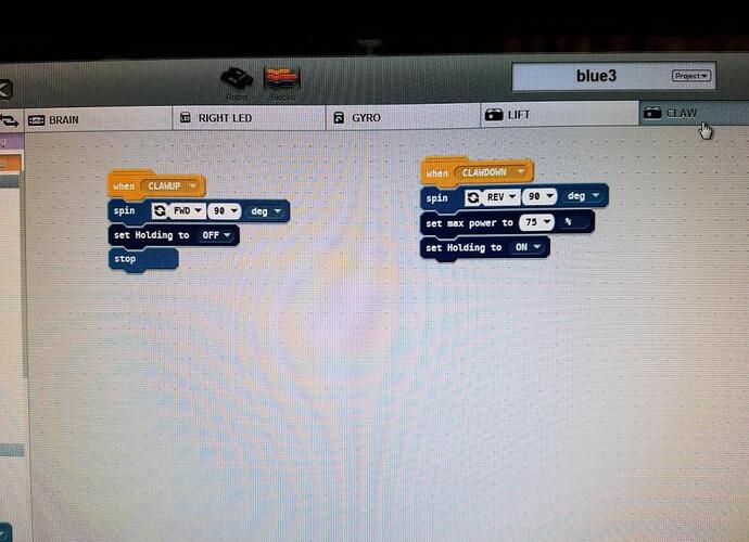

I’m sending some screem shots of our code. I appologize they are out of order. The drive train was too long to put on 1 screen shot.
Here are the next 3
Hello again, Osteocoach~
Had a bit of time this afternoon, and I was about to recreate your code when I really “looked” at the screenshots. It appears that you have when statements that are based on variables.
Your R. Touch led has a when for GyroAGo, but there is no broadcast for this. (This is a variable assigned to equal 1 by your gyro after it calibrates and resets its rotation. Without a matching broadcast of GyroAGo, there is no signal for your led to “hear.” In the same led code you also set a variable called startmoving to 1, which your drivetrain listens for, in the form of another when…
So, to clarify, variables do not behave the same as broadcasts. To activate a when, you need a matching broadcast. To use a variable change, such as GyroAGo, to activate another bit of code, you need a different set of ears to listen for this. Try a “when start” and a forever loop (else it will only check this code once at startup, and if the condition fails, will not run this code again). Inside the forever loop, put an if statement that says, if GyroAGo = 1… and place your code inside of this if loop.
At the end of this bit of code, either in or outside the if statement, you need to reassign GyroAGo to a different value, such as 0. This reassignment essentially says, “I’m done,” else the forever loop will restart (variable still =1)
This is where the new value, or a different variable can be used to activate the next bit of code. This could be your startmoving variable. Simply create a new forever loop in the drivetrain that watches for his variable change to initiate its code. Of course, the drive train could simply listen for the GyroAGo variable to be assigned a value of 2. This is the method I prefer. By using the same variable, when possible, you can end one loop and initiate the next simultaneously.
Either way, what’s cool about broadcast or variable change triggers is that you can write specific bits of code to turn, close the claw, lift the arm, etc. Place each set of instructions inside a when (broadcasts) or a forever / if loop (variable change), and you can use these over and over in a continuous chain of events without duplicating the same instructions for repetitive events. You can also test segments of your code independently, which saves time.
Please try one combination of triggers/listeners described above. If you are still not getting all of your code to execute, I would suggest adding your led into the mix. I teach my students to use forever loops and variable changes, but when they are having problems, I have them program their leds to listen to the same variable and to change color for each newly assigned value. That way, they can “see” which loops of their code are being triggered and which are not simply by noting which colors they see :slight_smile:
