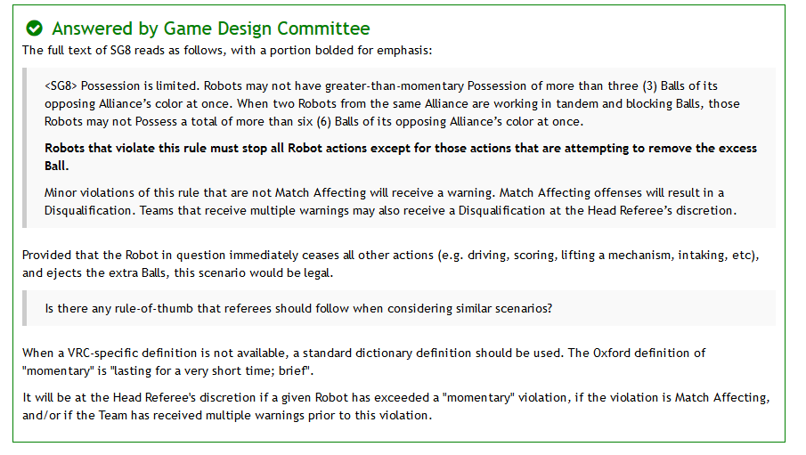

Momentary possession of 3+ balls
According to current rules, you can hold (for duration of match) 3 opponent balls and momentarily possess more than 3. Rules say 3+… does not give a hard number.
Team needs to know: if a bot is holding 3 (opponent balls), approaches a goal with 3 more, de-scores them via intake/etc (total 6), then immediately turns and ejects the 2nd set of 3, will they be within the rules? This would put them in possession of 3+ for about 5 seconds total.

The ONLY way to get a definitive answer is to get it posted and answered in the Official Q&A (found on Robot Events, not yet available). Any answer given to clarify a game manual rule that is provided any other way (including via your state rep) is merely a “best guess” and not a definitive answer that can be relied upon during competitions.
A Q&A question has been posted about this question, now that it is open.
Link to Q&A 601
It’s worth noting that a ball is considered scored while anywhere in the 3d space of the rings. It’s not till it completely exits that space till it’s descored and then capable of being possessed/controlled by ANY bot. This does not answer the question, but the ‘counter’ doesn’t start running till the ball is clear of the rings.
The GDC has replied. Please click the link and CAREFULLY read the original question so there is no confusion.
https://www.robotevents.com/VRC/2020-2021/QA/601
Yea overall it is still risky play to do, so just be careful of that if you do preform this. :slight_smile:
