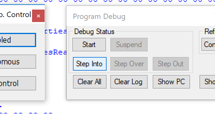

Using the code below I can reproduce the issue on two different robots. Once again the symptoms of the issue are that the natural language commands of forward() and backward() do not always work in autonomous. Other motor commands do work, including commands for the drivetrain.
In testing with this program the issue was not consistent. Sometimes one or two of the forward()/backward() commands were executed, sometimes all three, and sometimes the motors sounded like they were engaging, but the robot did not move. I used the competition switch simulator in RobotC to launch the auton. I started with the robot Disabled, did a Clear All, pressed Start, and then pressed Autonomous.

The one change that did consistently work (seven consecutive successes = consistent) was not starting the program when the competition switch simulator was set to “Disabled”. I stumbled upon this by accident. After testing something, leave the competition switch in Autonomous mode, then download the program so that auton starts automatically when you press Start. The forward() and reverse() commands always worked when running the test this way.
Of course, that’s not a solution, because in a real competition match the robots always start out disabled. For now, the only solution that we have is to not use the forward and backward commands.
