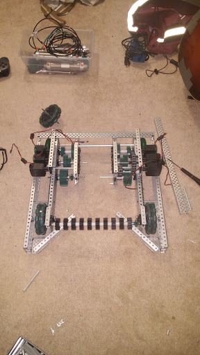

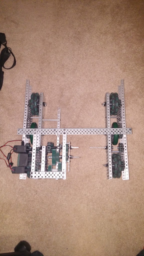

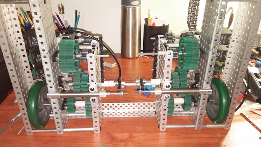

So I had thought about the same thing this year and found the perfect solution. A transmission! Best way to have speed or power at the push of a button. There are a few ways you could build them and the two speeds really come in handy. Im still in the process of fine tuning mine but ill attach a photo. We wanted 3 motors per side but the configuration it was in caused the chain to skip so its still being modified. I personally didnt find it to complicated to build, you just have to understand how they work and what it requires. Good Luck! [ATTACH]9466[/ATTACH]

Yes, I agree with transmission for power and speed.
