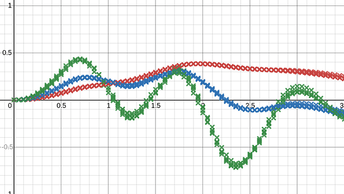

Ex. 1: Motion Profile Graph Beginning (RED: Position, BLUE: Velocity, Green: Acceleration)
Example one and two, of the tests performed, is the start of the autonomous. The robot starts with a cube in the tray, moves forward 12 inches, sets the intake to in full, moving forward 15 inches to grab two cubes, move backwards -5.5 inches, turning ~145 degrees, and sets the intake to out half power for half a second. In the process of the first movement, notice the motion

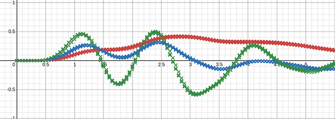

Ex. 2: PID Graph Start (RED: Position, BLUE: Velocity, Green: Acceleration)
profile’s acceleration. It starts to deviate from one another at the beginning of reaching the maximum velocity. With PID, the inconsistencies start to happen when it starts to slow down. They both need work to be more accurate, but you wouldn’t be able to tell the deviation unless it is graphed.
The same inconsistencies are minimal in both of the algorithms in the next several movements, however the PID algorithm shows an early start of being more inconsistent from run to run. This is because PID is a closed loop control algorithm, while a motion profile is an open loop control algorithm. A closed loop algorithm will adjust for subtle changes in the environment, while an open loop doesn’t adjust for them and you need to send in the extra variables and logic to make sure that the autonomous is correct.

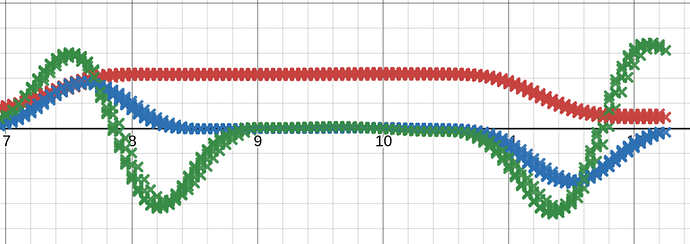

Ex. 3: Motion Profile Graph Ending (RED: Position, BLUE: Velocity, Green: Acceleration)
In graphs three and four, the second part of the autonomous mode occurs. During this movement, the robot: moves forward 17 inches, sets the tilter for the tray to go up, delays 1.9 seconds, sets the intake to out half power, waits for the tilter to settle, sets the tilter down, and moves backward 17 inches. In the movement, there is a large change in the center of mass in the robot (the tray and cubes), so it is expected that there is more variance in the kinematics.
If you look at the first peak in acceleration, (green) in the second graph, one of the lines settled later compared to the other lines. This tends to happen with settlers because each run is different. Despite that some runs take a little bit longer, the algorithm still works, and the change in real life is so slim that you can’t tell.
The biggest thing that I noticed during the movement after placing a stack is: when the PID is run, it fully throttles the robot backwards. This resulted in vibrations in the tray and robot. While this can be fixed with having less vibration in the robot, the motion profile algorithm was just as smooth as usual with the normal parameters. This is a good example of the biggest flaw with PID: a common way to limit how fast the robot goes is to adjust the voltage.

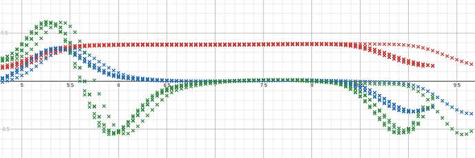

Ex. 4: PID Graph Ending (RED: Position, BLUE: Velocity, Green: Acceleration)
However adjusting the voltage, with a PID loop, will adjust the gains of the loop enough to mess it up. To do this, lower the max output voltage, and adjust your parameters (retune) when making movements that need to accelerate slower. This process is tedious and annoying. It is common that there are two or three fully tuned PID variables to manage for a routine, and tuning one set of PID variables takes a lot of time.

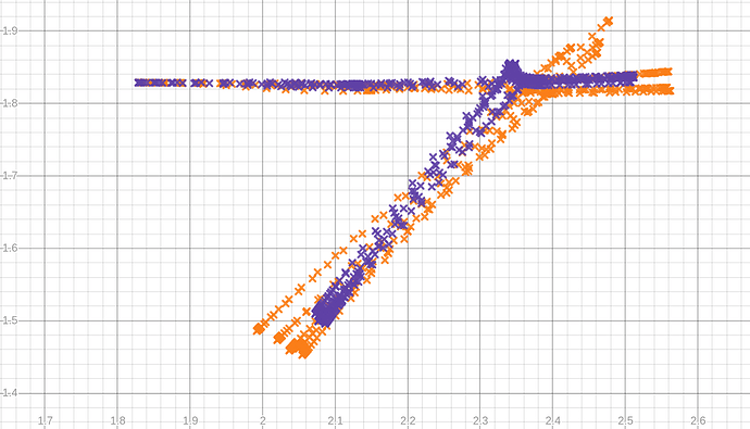

Example five is a comparison of the position data of the robot during the autonomous routine between PID (purple) and motion profiling (orange). While PID has slight variations in following the path that can and will grow to accumulate error, the motion profiling movement is clearly not meant for precision and will accumulate error over time. This lack of precision is the biggest problem with motion profiling.
It just can’t compete with PID on precision, because it is inherently an open loop movement algorithm. In autonomous modes, this lack of precision is often combated by pushing the robot against a wall of the field to straighten the robot directly

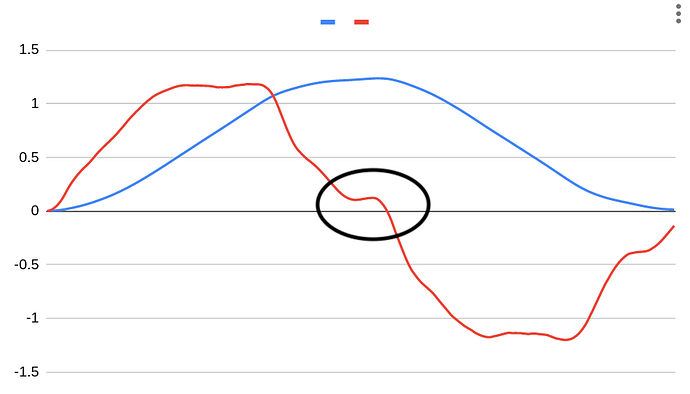

Ex. 6: PID Forward and Back Movement (Blue is Position, while Red is Velocity)
The biggest problem with only using the motion profile algorithm is the fact that it can’t adjust to correct for disturbances (due to it being open loop). This can be solved by what PID does with the integral variable (ex. 6). It has an output for when the robot is at the very least voltage or velocity that it can be while still providing movement.
This can be implemented with the open loop motion profile algorithm by running the movement. After running the motion profile, it has a simple closed proportional loop that outputs the minimum moving velocity (either positive or negative depending on the error) with an exit loop settler. This will enable the robot to get to the desired position (be accurate) without running a PID loop.
