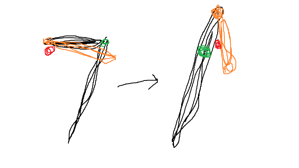

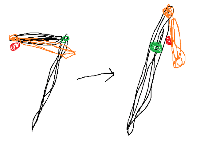

This would be a great idea for forklift people. But, since I have not really gotten what I need, I’ll tell you what I need to be released. So I have a design were my intake looks like a 7 at the beginning, I have everything worked out but how to release the top part so it can flip out, at the end, it will have doubled in size and is like a /.
I have an idea, but might need some tweaking to get it working.
Black: intake
Green: pivot point
Red: stops
Orange: rubber bands
[attachment:5778a06ede0f8][attachment:5778a06ede0f8]
By inertia, the black top part will flip out a little bit. It just has to flip out enough so that the rubber bands will change the direction that it pulls the top part.
