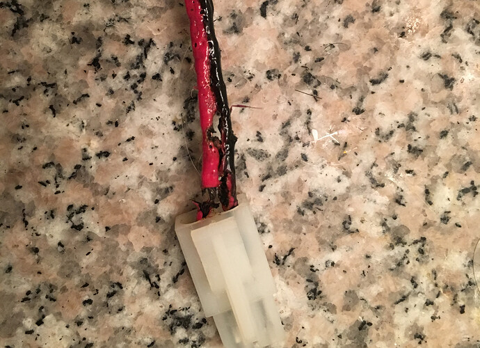

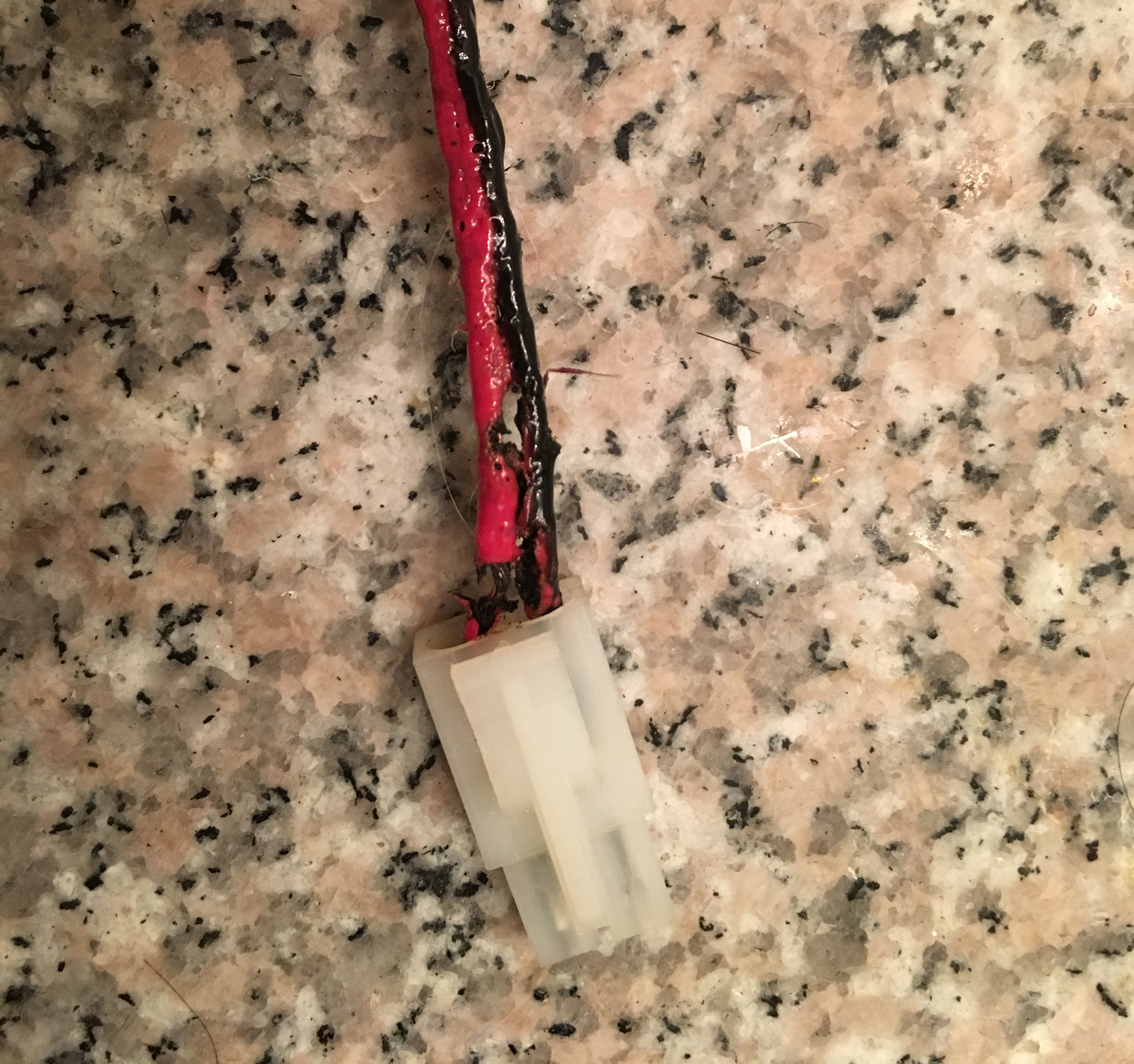

Hi All.
I was able to run the arms and keeping them in 92 kept the arm strong.
But I ran into another strange problem.
Suddenly the wire from the 7.2v battery started burning.
It started burning from the battery end and continued towards my PCB and. I disconnected the power before it reached the PCB.
Any idea in what situation does the battery wire burns? High current draw or faulty connection or something else…
Attaching the burned wire picture
Seems like the battery shorted somewhere. I’ve made the mistake of accidently shorting batteries while measuring them, and they get hot fast. If the fire started near the batteryitself, it might’ve shorted near where the wires meet the battery pack.
Ok that makes me a litttle comfortable to know it’s most likely shorting issue rather than my circuit.
Because nothing fried on the PCB.
I will replace thee battery connector and try again tomorrow.
Btw the wire that comes out from battery pack is not damaged. It’s the one from connector to PCB. So should I also investigate the battery pack connector?
