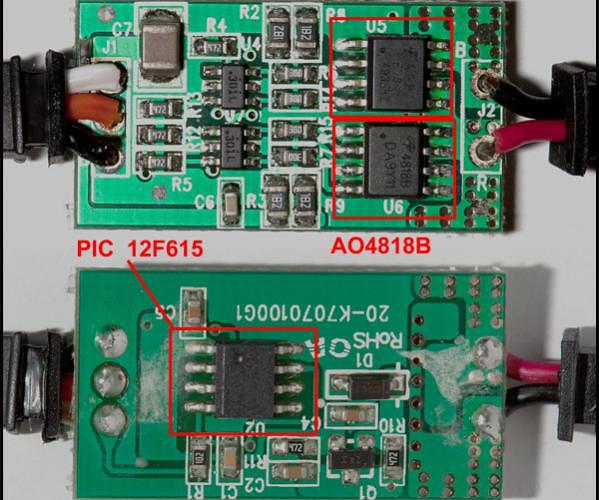

You actually posted this… (see attachment).
Anyway this is the PIC in the MC29, it seems to have a 10 bit ADC soo… I’m guessing you’re just going to get 10 bits of precision out.
So @jpearman, is that Adafruit board going to cook or do you think I can use it to drive say 6 393’s?
You could use that board. V+ goes directly the the center pin on the motor/3wire connector, that would be unregulated battery. Vcc needs to be 5V or less and you need to pull that from somewhere else, don’t connect to the 7.2V battery. But why? What are you trying to do?
It’s nothing to do with the ADC. The pic will use a timer to measure the pulse width, whether that’s hardware or software I don’t know. The precision of the timer will theoretically determine the precision. Then the PIC needs to generate the actual motor PWM waveform, again timers are used, we don’t know how. It could be measured but I never have time for these experiments anymore.

Hey @jpearman,
While I have you here, do you have any idea why VEX used two different MOSFET’s on the MC29’s H bridge? I’m not an expert on H-bridges but that seems strange.
You use 4 FETs to create an H-Bridge, two N-channel and two P-channel. Somewhere I posted diagrams on the forum but I can’t find them right now. Scroll down through this page and you will see the explanation as to why.
