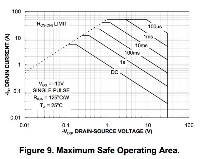

The MOSFETs should be able to handle the current transients, they are rated for up to 50A but only for very short periods of time. However, after thinking about this some more, if the controller is shorted then I think it will probably fry straight away, the cortex PTC is going to be too slow to protect it. From the AO4818B datasheet;
[ATTACH]6977[/ATTACH]
In normal operation VDS will be small, the FET has a 20mΩ resistance, the motor is something like 1.5Ω so VDS is perhaps 0.1V. If the MC29 is shorted then VDS is perhaps 0.3V, it’s going to depend on other resistances in the circuit but for the sake of argument lets assume they all add up to 0.5Ω. 7.2/0.5*0.02 = 0.288V. current would be 7.2/0.5 = 14.4A. From the graph above follow the 0.3V line up and with 14A the FET will overheat after somewhat less than 1 second. This is a bit outside of my area so perhaps my math is wrong here, any thoughts Chris?

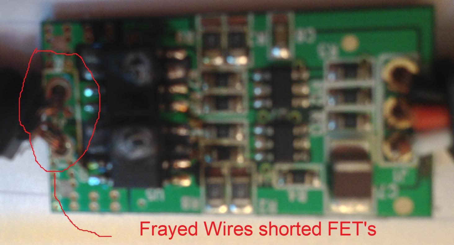

I think you are right about a short causing the problem. Teams should suspect the two wire connections between the motor and the controller when a controller smokes. I can see this as being a real hazard for burning out the Cortex FET’s.
https://vexforum.com/attachment.php?attachmentid=6982&stc=1&d=1355346339
I decided to open up my fried M29. You can see the burnt FET’s but it seems that the wires had frayed that connect the motor. Several strands of bare copper wire had broken loose from the main bundle and most likely shorted the FET’s. Not sure if you can see it with my iphone 5 picture but I am 90% sure that was the cause. Upon closer inspection, it appears that the stripped wire was a bit too long and protrouded excessively from the solder joint. There is a lot more bare wire showing compared to the wires shown in the M29 picture you posted earlier in this thread. This might be a quality contol issure or a design problem or possibly the insulation was pulled away from the joint after it was soldered (again a grommet problem).
https://vexforum.com/attachment.php?attachmentid=6988&stc=1&d=1355351154

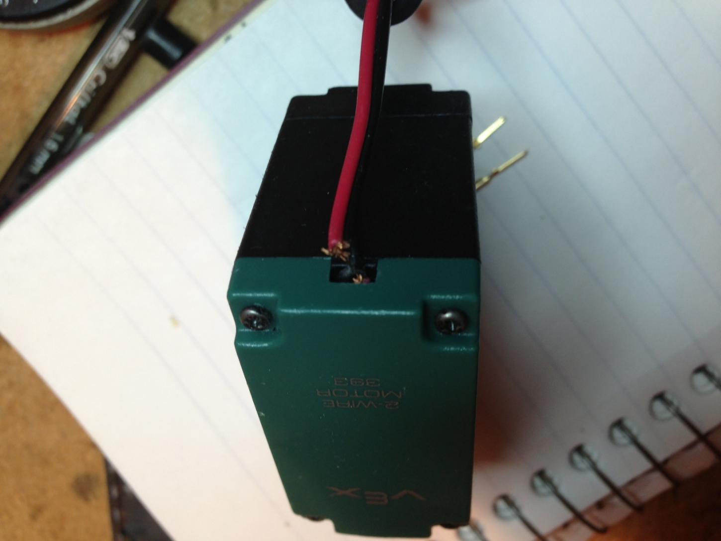

Here is a picture of a frayed 393 motor wire which had a missing grommet. This is another likely place for a short.
So I think the two-wire rubber grommets which break off on almost all our motors and some of the M29 need to be rethought by Vex. They are not providing adequate strain relief with normal competition wear. When the grommets dissappear, then the wires are sure to eventually wear through the insolation and short the controllers.

On closer inspection, there seemed to be a pinch on the motor’s wire just after it entered the motor. Although there were no visible frayed wires as in Vamfum’s picture, the pinch must have been the location of the short. New motors seem to have fixed the problem, but we’ll have to see when we do more intensive practicing later. Thanks for everyone’s help,
Eric
That’s a well abused motor, never seen one like that before. It’s not a great strain relief but I don’t think they are that bad, not really designed to support the wire if pulled at an angle or really hard but just to protect the wire going through the housing.
