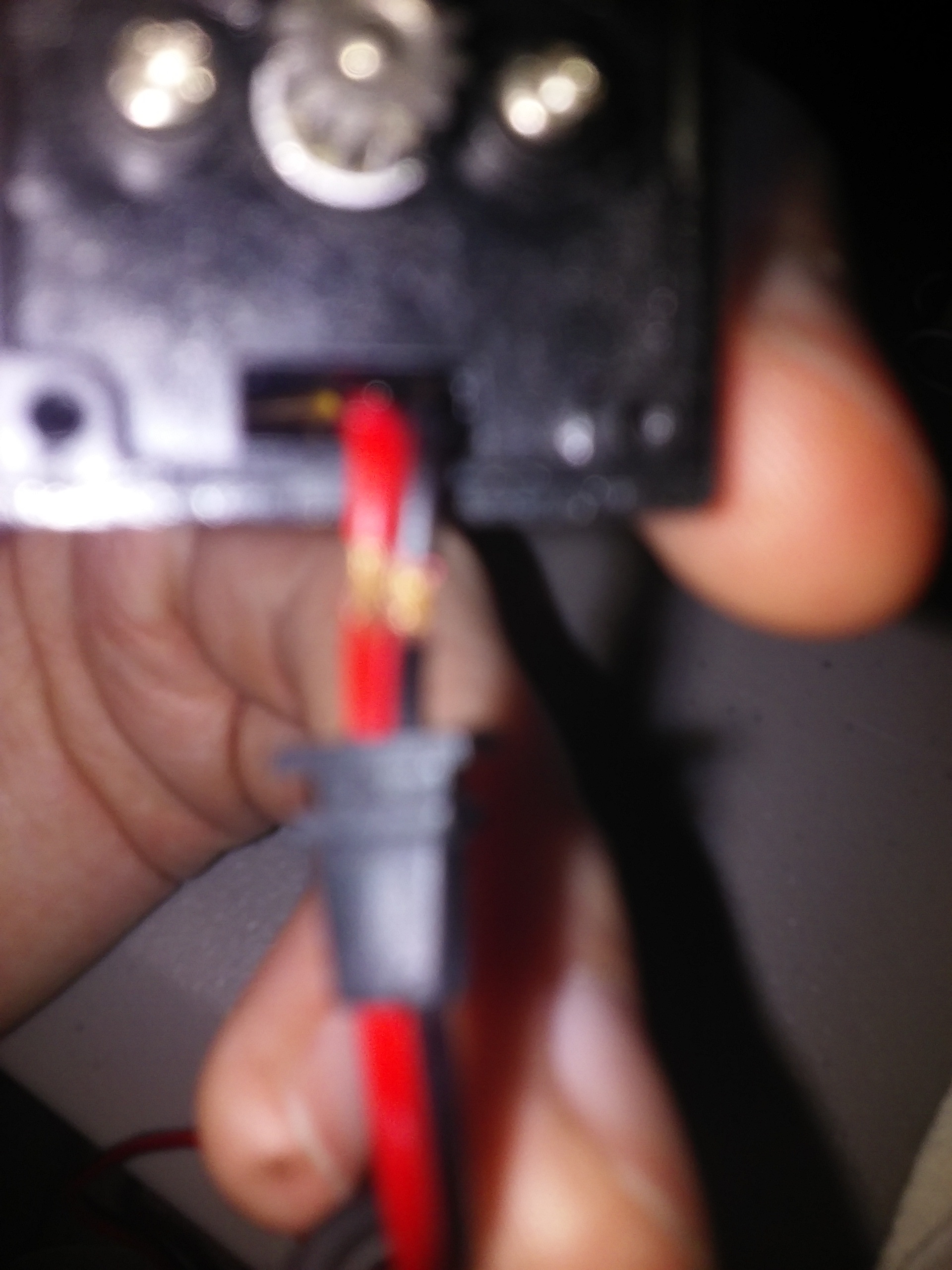

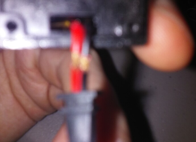

Attached is a picture from the problem motor…
I slid the grommet and revealed this lovely short! So all of y’all’s speculation was correct. Does anyone know how this kind of thing happens, especially under a grommet?
The grommet is useless. This has happened to us before as well.
But for real, how does the wire get exposed like this? What causes it?
Can confirm that the grommet is useless
I would recommend removing the grommet and putting some heat shrink tubing in its place while the wires are still intact.
I second this.
It happens because the insulation gets old and then when you bend it, it cracks and then it all goes down hill from there.
