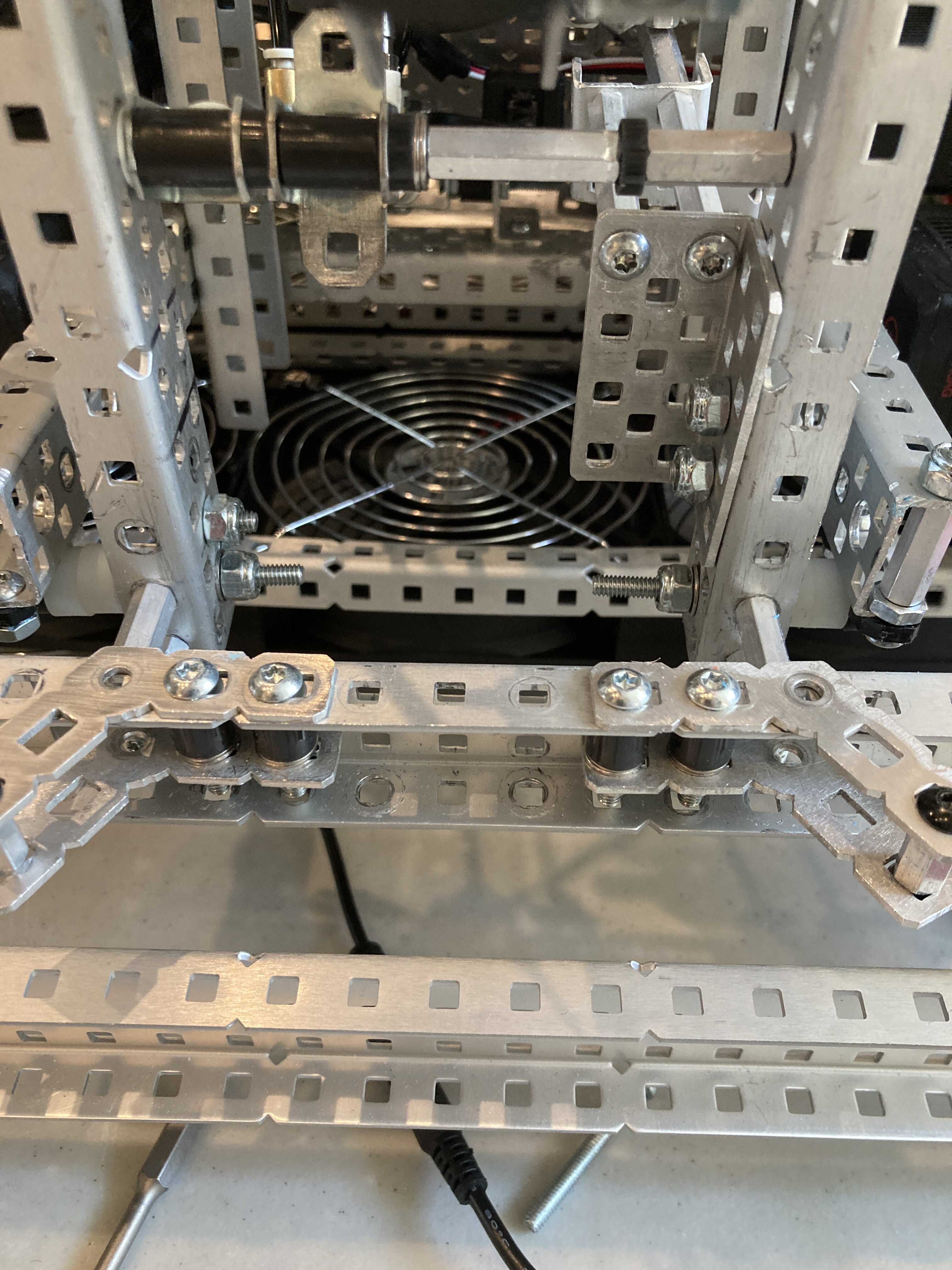

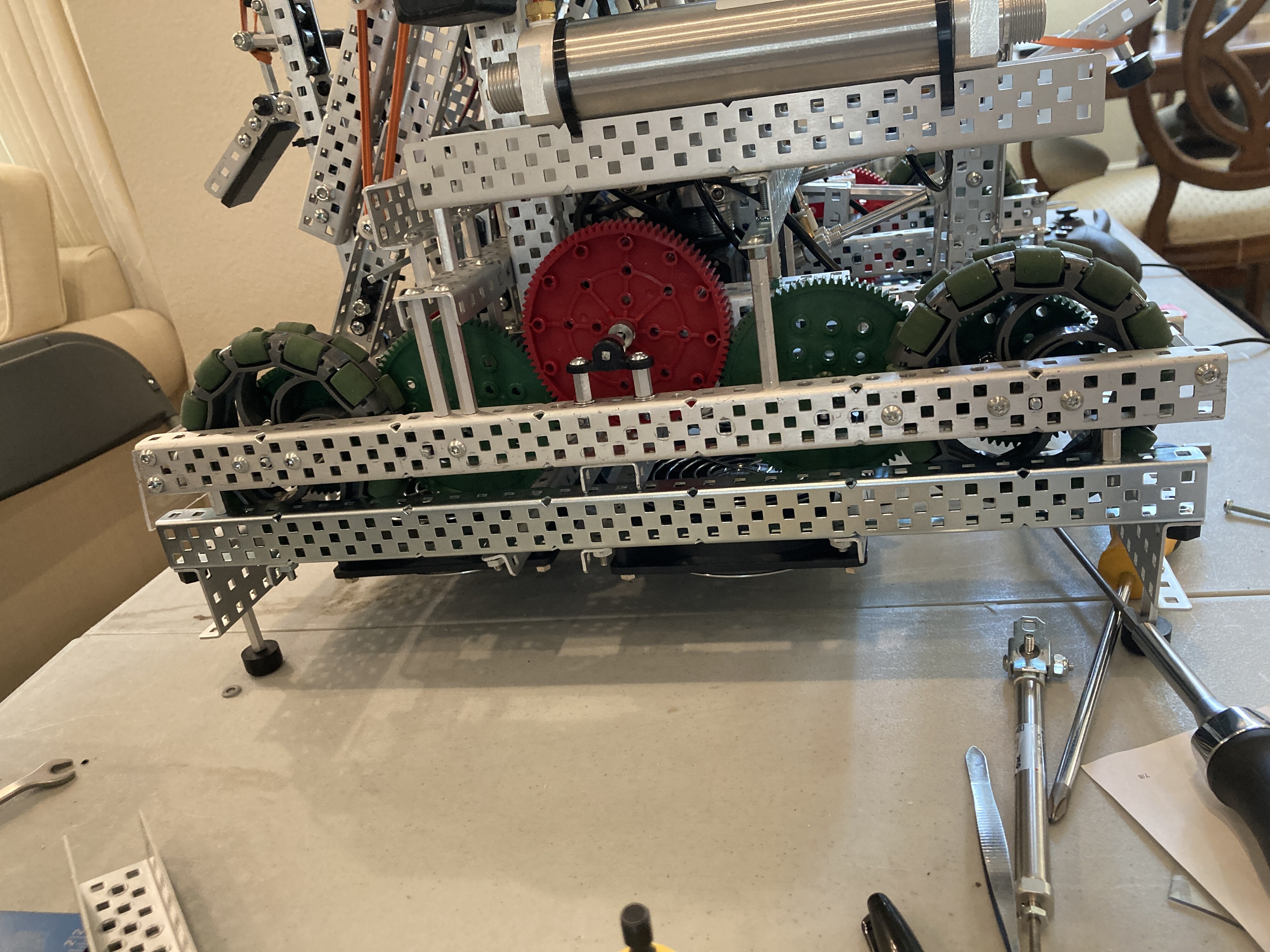

I’ll get pictures of just the base later today. But it’s just a couple 35x c-channels with 6 140 mm server fans off Amazon. They come in sets of 3 and have an external psu and speed controller. Works pretty well and it’s not to loud.
Do hot swap. Rubber band your motors together so that you can take off the back part and swap it out for one of your spares.
It works sorta well
Takes a little bit to cool down the motor but way better than nothing. If you had two on each side of your motors they would cool it super well, but that’s like $640 to for all 16 coolers, and it would use your tournaments entire electricity output. Best solution: fridge or quickswaps
