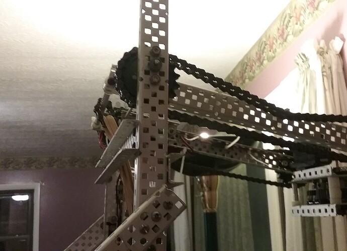

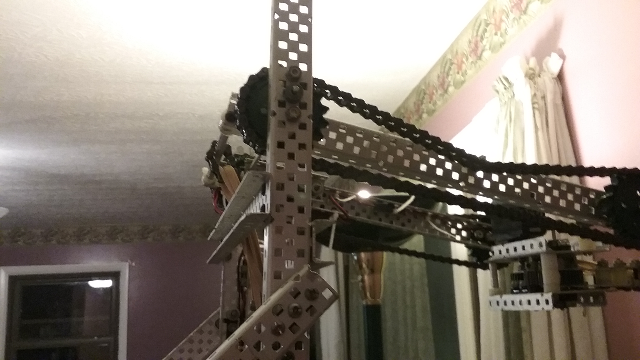

Also, do you have that chain bar built? Seems pretty ambitious for one motor, but I haven’t tested to know for sure.
I mean 2 motor turbo 1:5 can do it so i don’t see why like 1 motor normal 1:5 couldent do it.
I decided i rather save air for the mobile goals and transmission since when testing it wasn’t the best at conserving air.
Yes i’ve tested the chain bar. However, i haven’t had it go through the strain of a competition but oh well :stuck_out_tongue:
Attached is a picture of the rubber band setup i have with it. It’s made so that it’s always pulling the chain bar up and towards the center; so that’s worked pretty good so far :slight_smile:
Note: the reason it does this is that the rubber bands are attached past the chain bars pivot point so as it swings around the bands go under the pivot then back and up just in the opposite direction :slight_smile:
