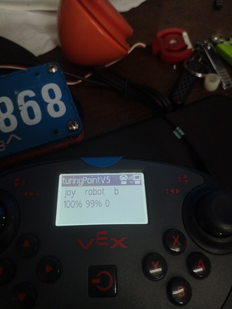

My student said that the main problem was the length of printing.
Mingming remote control screen still has space. If it’s longer, it’s useless.
  joy1->print(0, 0, "joy  robot ball");
while(1)
if (_timerDisPlay.getDtFromMark() >= 100)
        joy->print(1, 0, "%d%% %.0f%% %u", joy->get_battery_capacity(), pros::battery::get_capacity(), getBallNums());
        _timerDisPlay.placeMark();
    joy1->print(0, 0, "joy   robot   ball");//Adding more space
And :
It seems inaccurate. Is there something wrong with my usage? :disappointed_relieved:
No, I think you are just running into the limit we have on string length able to be sent to the controller.
