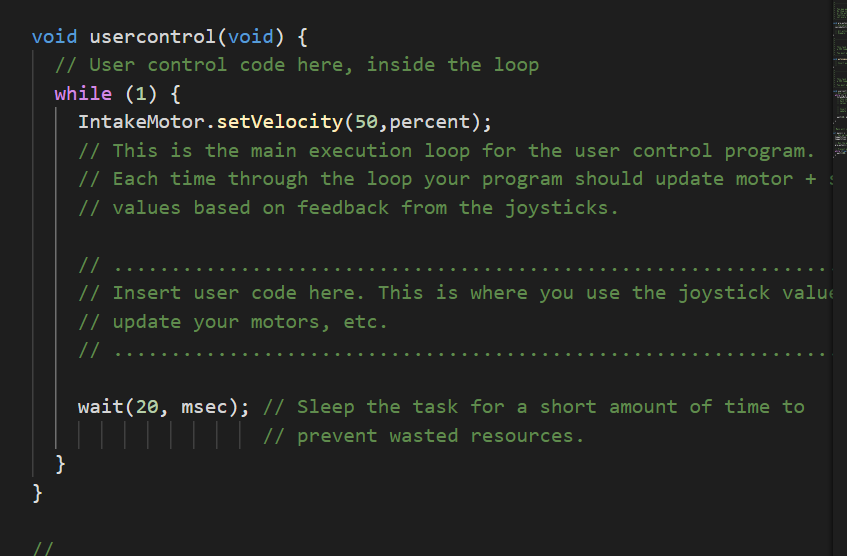

The only code we put in user control manually was the MOTOR.setVelocity (75, percent);

When I remove our SetVelocity code, then it works fine both directions. So my code appears to be the problem.
I think it’s because of the motor.setVelocity command. It should automatically set the velocities by default based on joystick inputs. Try deleting that line. I’m pretty positive what is happening is that since it is a positive velocity, it will only go forward rather than backward. If you want to control the motor velocity during drive, I would recommend programming a custom drive.

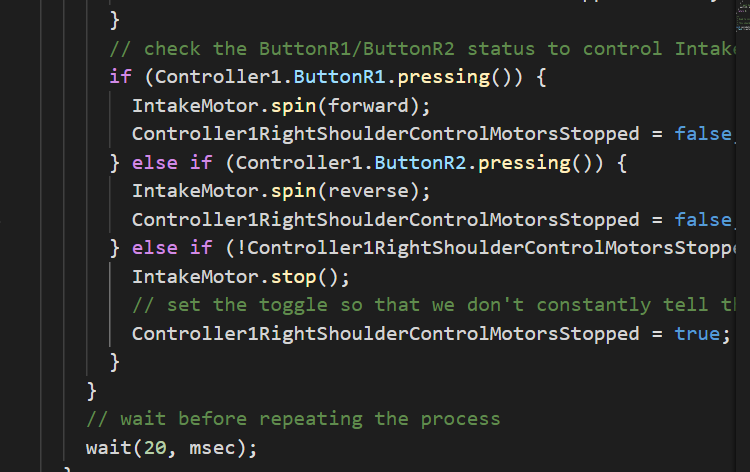

That shouldn’t cause a problem. Can you post your controller set up?
Here is the robot config code from the controller setup. Maybe the manual code and this preconfigured code are interfering with each other?
Screenshot 2021-01-13 090648
That is probably what is happening. To fix that, just program the intake motor manually.
Thanks for the help. It most likely is the problem, however, I dont see a set velocity in the controller setup. I just see the .spin commands.
