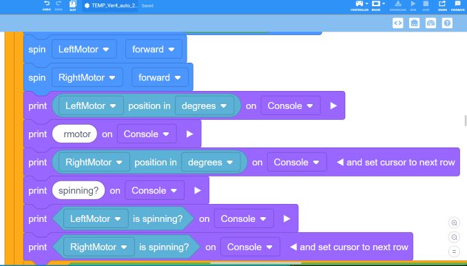

Trying to detect if motor is spinning. Running code as shown below, console shows LeftMotor and RightMotor position changing, indicating motors are spinning. Print statement “spinning?” shows negative for both LeftMotor and RightMotor which, to my understanding, indicates that the designated motors are not spinning.
Spinning2
Would be grateful if someone could set me straight as to what am I missing here?
isSpinning is only used with spinFor and spinToPosition commands. It is used to determine when they are complete (ie. if the motor is spinning to a position) if called with the “wait for completion” parameter set to false.
