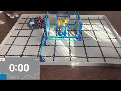

Me and my team have created a robot that can hang high and score 152. Using slip gear we got our hooks to stay up and hang high. Just recently our high hanging hooks were not working as it was supposed to. My team and I researched online and found motor less high hangs but can’t seem to figure out how it works. We made our hooks and placed the rubber bands but it would not repel when our high hanging bar goes up.

Thats why we are changing it. We found out 2 days ago that we are using an illegal part. Back to the main question we are trying to make a hook to repel when the arm moves up but me and my team have been failing a lot. The robot is at my teammates house but this video shows what I am talking about.

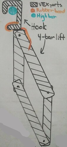

I am talking about the hooks. I have the gear ratio noted down but can’t seem to figure out how the hooks work. Only thing I know it is powered by rubber bands.

Here’s a diagram. The idea is to have the rubber bands not stretched at all when the mechanism is down and stretched at least some when it’s up. I guess you’re using a 4-bar? This is roughly how we have ours.
