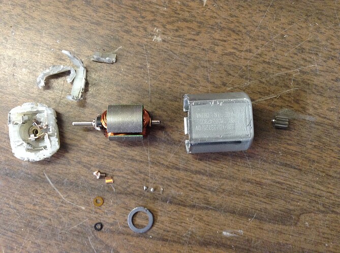

In this case, it looks like mechanical damage, because of the rattling parts inside V5 motor.
Probably, a brush or solder point fell off and got stuck somewhere between rotor and case or collectors.
