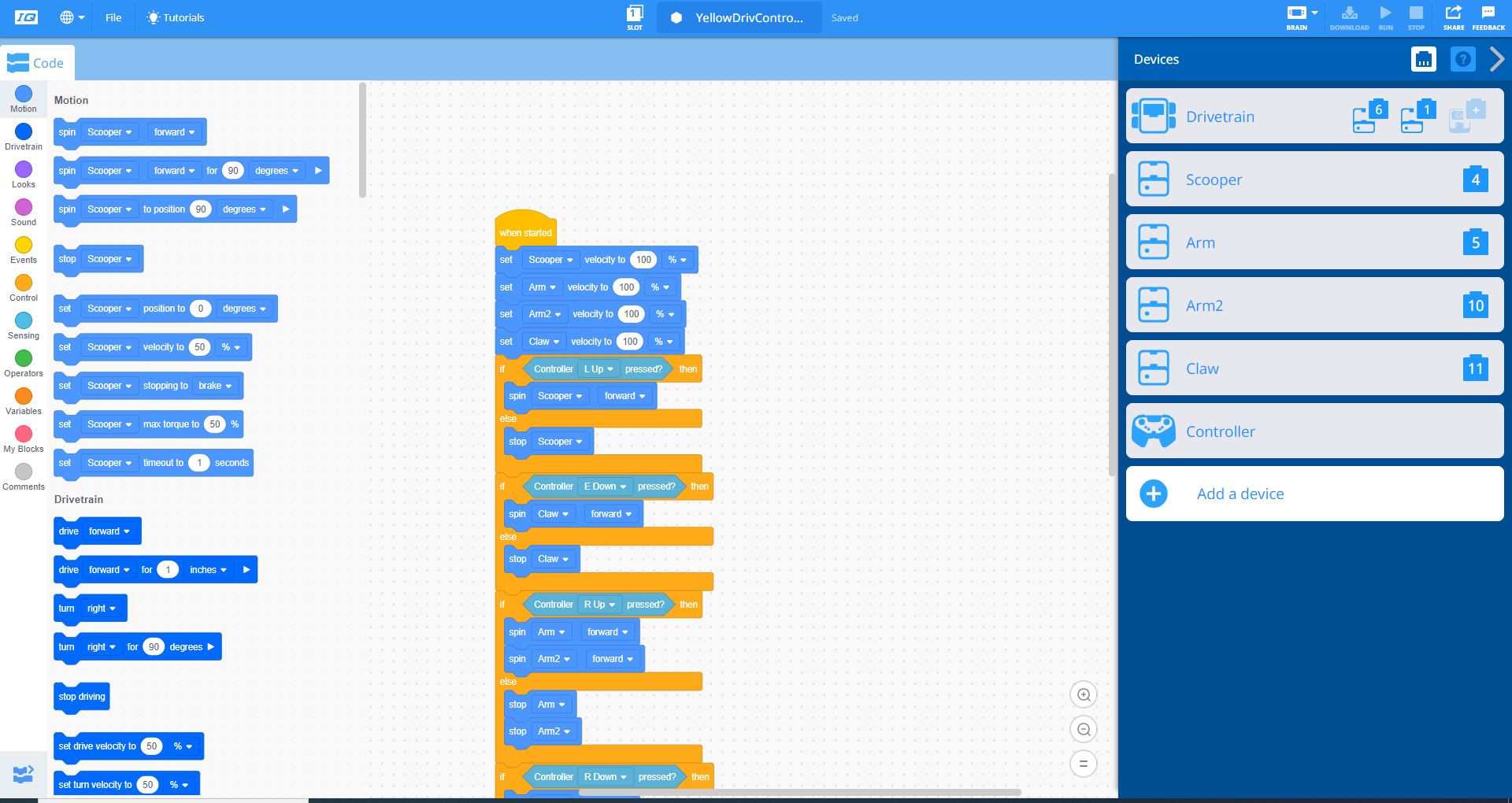

Motor moves back when I move it forward with a controller VexCode Blocks
Whenever I move a motor with a control, the motor moves back slightly. I don’t know why, I will post the code here. Vexcodeblocks
Please elaborate on what you mean by
For example, when I press L down, it moves it slightly back up.
Does it move back and then move in the desired direction? Ifnot and it is only going in the wrong direction, try reversing it in the code
It moves in the desired direction and then it moves back.
so if you want the motor to keeps it’s position, then use brake type hold
Ohhh thank you so much, the problem was that the motor could move when I touched it with my hand.
How would you implement the brake code for the code I provided?
I believe you have the different brake types so:
Just put under the when started block
