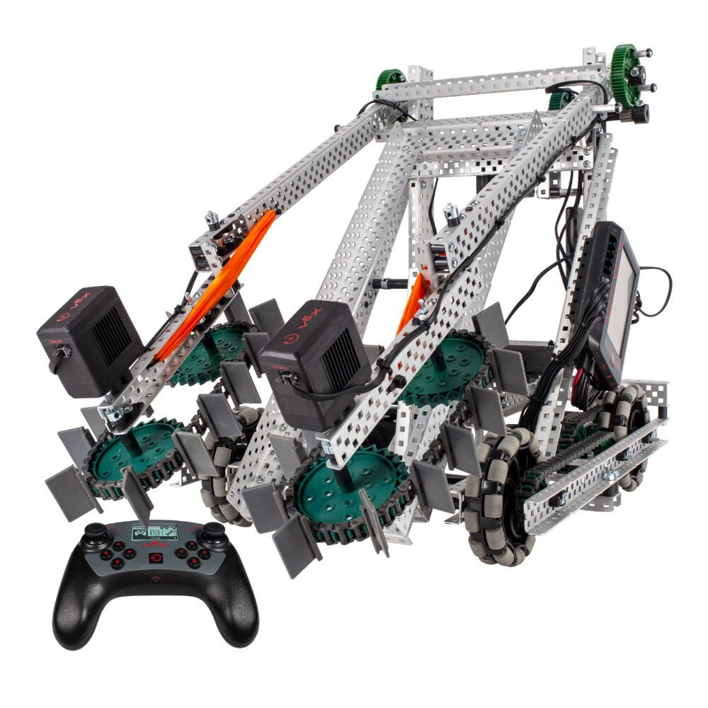

We’re having major errors with our program we have built for a competition coming in 2 days, and if we could get some help that’d be great.
The error we’re having: the bot moves forward a significant amount prior to activating any created code.
Here are some pictures of the current code. Are there any problems with the code? Or is this an error within the bot’s brain?

I suppose I should’ve gone into more detail above. Our bot is built optimized for the Tower Takeover competition. It is a 4-wheeled bot (leftAltDrive, leftMainDrive, rightAltDrive, & rightMainDrive) with a tray that can rotate in the center for stacking blocks (alignTrayMotor), two arms that can both be lifted as a unit (spinFlipMotor) and they have brush-like wheel attachments on the end that allow it to scoop block onto the tray (leftSpinMotor & rightSpinMotor)
The bot is meant to go forward with Left and RightSpinMotor spinning inward. As it goes to a row of blocks, the brushes push the block up the diagonally aligned tray in the center. Once the tray is full, the bot then returns to a corner (where collected blocks are stored), flips the tray, and leaves the blocks in a stack.
The problem we’re facing is: when the program initiates, the 4 driving motors seem to rotate somewhere around 1000 degrees, then it starts the rest of what is programmed. We know all the motors are in the correct ports because the controller works correctly with each button activating the correct motors.
I was able to find a similar looking picture of the bot on the internet, as I am currently away from the bot.
Hope this helps you understand the scenario!

In short, I think I found out the problem: although the program was told to broadcast OmNomNom, it instead was broadcasting DriveForward1440. Why? No clue. However, I tried removing the broadcast system entirely and was able to get it to work! So now I just need to make a few tweaks to finish up some turning angles and things, and then, hopefully, it’ll work.
Thanks to all who helped!
