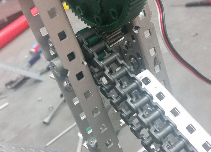

I have an internal stacker and I put my motors down by the base and chained them up to the tower. I don’t have to lift them this way and they aren’t in the way of my dr4b as It moves past that area.
Yeah, like I said, I’m terrible with wiring. Having the wire moving is another concern, but a minor one at best (worst?).
EDIT: Never mind, it seems I can’t read.
If you dont mind me asking, what gear ratio are you using, and do you find the friction from the chain to be noticeable?
Holy cow. That is hilarious because we did the exact same thing for our mobile goal lift (initially). That looks like a picture of what our robot used to look like. It would be what we do if we put motors on the bottom for our lift, too. Not much space to work with.
