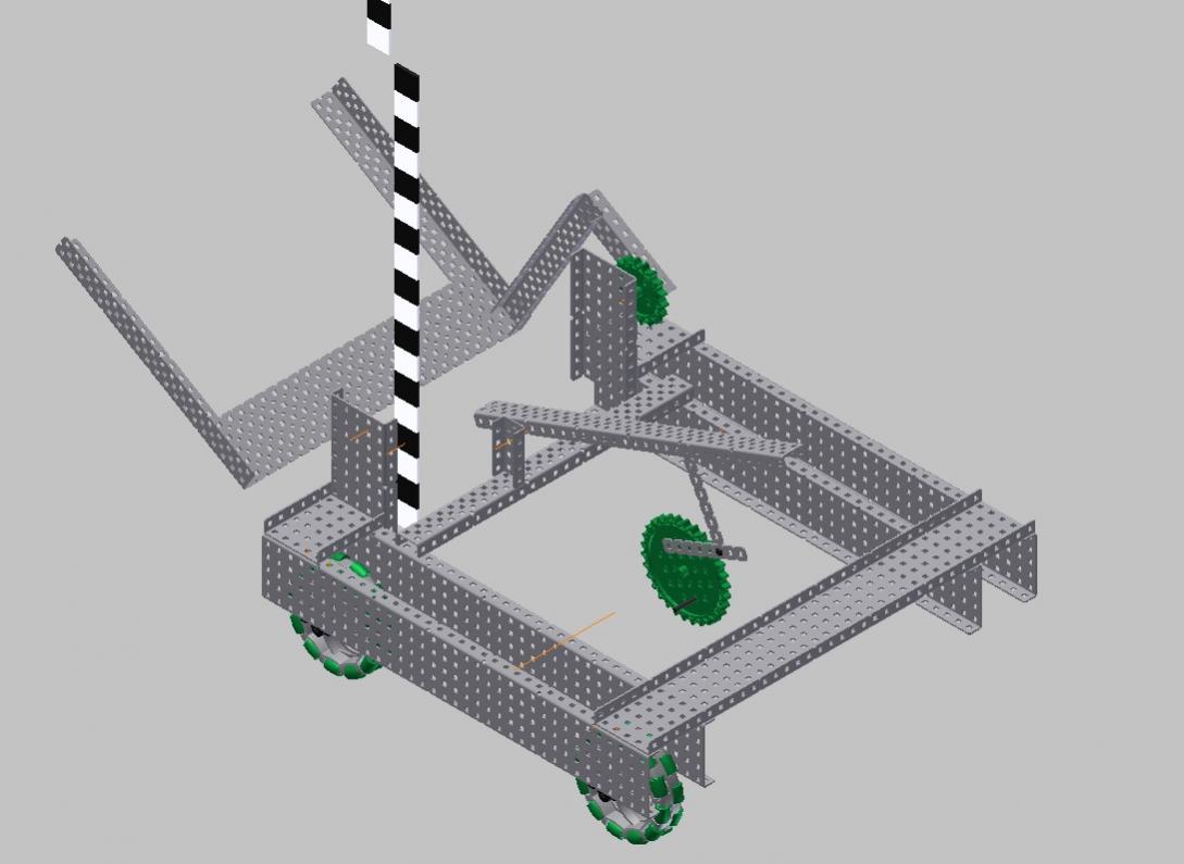

We tried a prototype last week, I was working on the choo-choo in CAD today.
[ATTACH]8057[/ATTACH]
And have the beginnings of the real thing. It’s hard to see from that photo but it used a small turntable driven by a 12 tooth gear.
[ATTACH]8058[/ATTACH]
The students want to go with pneumatics though so I doubt we will finish it. It’s also pretty violent when it fires.
Two questions:
  1. do you use 1 or 2 motors
  2. how many rubber bands / elastic tubing are you using.
At least I’m not the only one with this crazy idea.:smiley:
I like it though.:slight_smile:
One 393 motor is used to pull back the launcher, the final gear ratio is not decided but the prototype used 5.5:1 (ie. small turntable)
We used the latex tubing, probably looped around 20 times, the launcher used a 1x5x1 C channel strengthened with a 1x2x1 C channel (different from the CAD, that’s just for working out some geometry issues). The robot is designed to handle beach balls only (a strategic move based on previous game observations and, well, because that’s a different strategy and looked fun), it was launching a beach ball from the bump over to the goal zone consistently. Anyway, as I said the students wanted to also try pneumatics so it has now been modified for that. The advantage of the choo-choo mechanism is that is does not run out of air :slight_smile:
The launcher need to be built to be robust, there is a lot of stress on the launcher as it waits to fire, you need to keep safety in mind with these types of mechanisms.
Thanks for the specs, and the quick response.:slight_smile:
We will, if we decide to do it, we will start with a low amount of elastic and work it up till it is the correct amount. Probably with the amount of stress, every thing will be double and triple checked for robustness and durability.
Thank you jpearman for your time and ideas.

The motor is not used to launch the catapult, it moves the catapult to the pre-launch position, elastic force is used to power the catapult.
