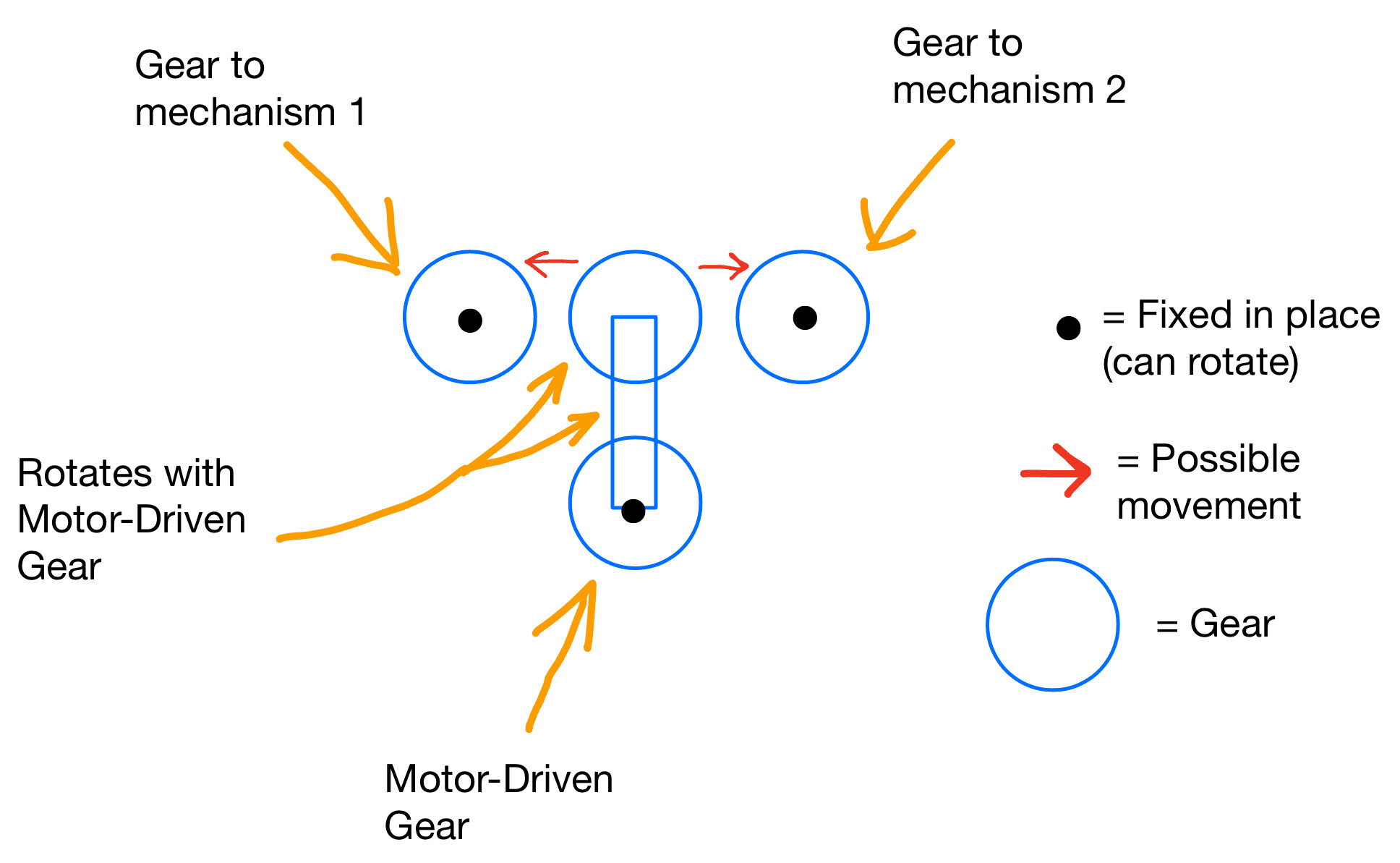

Is it possible to get a Pto or something that has the equivalent function using a motor to actuate it instead of a piston
Yes it’s possible, however it kinda defeats a lot of the purpose of a PTO
If you still want to make a motor-driven PTO, here is one way to do it:
