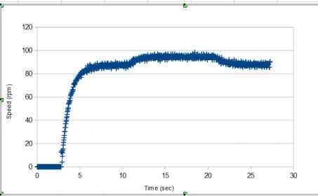

I am using turbo motors and the appropriate ticks per revolution. I expected to see rpm values at full motor power around 200-240 rpm. Instead, the values maxed out around 100 rpm. My debug stream data is attached. Am I wrong in thinking my output from the above calculation should be just short of a 240rpm no load speed?

Thanks, I think I found my own problem, here:
//encoder counts per revolution depending on motor
#define MOTOR_TPR_393R          261.333//counts per rev for standard (torque) geared motor
#define MOTOR_TPR_393S          392 //counts pre rev for speed geared motor
#define MOTOR_TPR_393T          627.2 //counts per rev for turbo geared motor
After reading the documentation on the IME, looks like the counts per rev for torque and turbo need to be reversed.
Yes, turbo has 261.33 counts per revolution of the output shaft. I guess you added the comments, they were not in the original code.
