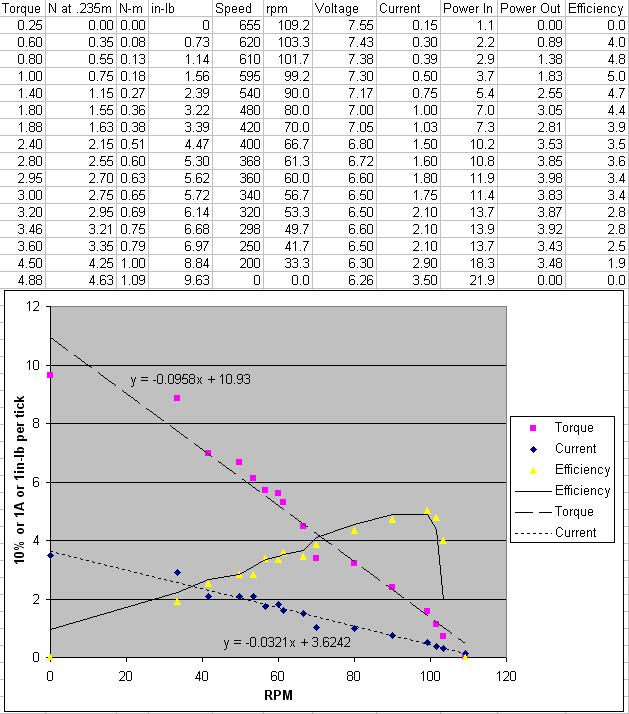

Suppose you have a fixed 7 in-lb load powered by one 393 motor:
What does theory chart suggest happens to the total current through the PTC
if you add another 393 motor that shares the load equally?
So here we go:
*By “per tick” on the y-axis scale, I mean “per single-integer increment”

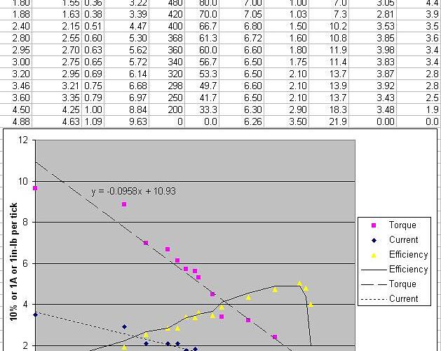

Some interesting results:
The free speed was closer to 110 RPM than 100 RPM (this is partially explained by the battery voltage being 7.55V, not 7.2V).
The stall torque was closer to 9.5in-lb than 13.5in-lb.
The efficiency keeps climbing until about 90% of free speed, at which point it quickly drops off.
Conclusion:
I’m going to maintain that the best speed at which to run the motor is between 65% and 70% of its free speed.
50% to 55% is best for maximum power out.
About the equipment and procedure:
This was done with an almost brand-new 393 motor, powered from a 3-wire port via a motor controller 29 at an input value of 127.
The measured torque is the torque that is required to keep the motor case from rotating, so the readings are the exact torque that the motor outputs. The current and torque were very jumpy, but we tried to pick a value that was on the middle-to-high end of the values.

Here are the pictures of the setup:

The black box on the table is the force meter. The black box on the stand is the rotation counter. The larger multimeter is the ammeter. The smaller multimeter is the voltmeter.
The circuit:
Cortex
Motor Controller 29
Ammeter
Voltmeter Probe 1
Motor
Voltmeter Probe 2
Motor Controller 29
Cortex
The voltage across the ammeter is about .3V at 3.5A, but that doesn’t really matter except to say that at higher currents, there is less voltage being supplied to the motor. The values above give the voltage across the motor.

Has anyone tried these tests with a older 3-wire motor?
I have not done any tests, jgraber did some almost 6 years ago and posted the results here.
https://vexforum.com/showpost.php?p=2603&postcount=3
This is the theoretical graph created in the same way that I did for the other motors, it is based on the numbers published in the inventors guide.
Thanks for finding that, I had forgotten posting it.
Similarities to dontworryaboutit’s data:
  • free speed is 110 vs 100 rpm speced.
  • measured stall torque is well under spec:
    – jg: 6yr old 3-wire data: stall at 4.3 in-#, vs spec of 6.5
    – do: 393 torque mode: stall at <10 in-#, vs spec of 13.5
    (too bad power out is only tabled, not plotted)
Designing for 60% of max datasheet torque on paper,
may put you at 80+% of available torque in practice.
Was the rated stall torque for the 3-wire motors 6.5in-℔? Its product page appears to be gone.
So now the question is:
Where’s the torque being lost? Is it in the meshing the internal gears? Is it because the motor itself is overrated? Is the rated stall torque actually the peak torque the manufacturer ever recorded?

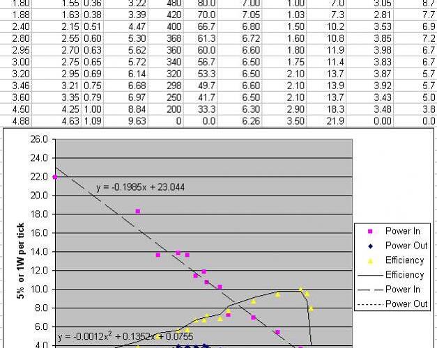

Here’s your Power In v. Power Out graph:

I also want to say that the original point of this post was to try and determine if a 393 motor was going to over stress the cortex and pull too much current. If we turn the whole argument around and say, “I have a 1A current budget, what can I do with this”
The theoretical answer is.
The 269 motor can give you 2.93 in-lbs of torque at 66 rpm. (and will trip it’s PTC sooner)
The 393 motor can give you 3.38 in-lbs of torque at 75 rpm.
There are obviously other design considerations but in this simple case (assuming you can determine current and I will get to that in another thread soon) the 393 is the more powerful choice.
Huh. So when they say that you’re allowed to use 10 393s but you have to take into consideration whether you want to be drawing that much current or use the 269s, it’s simply better to use all 10 393s?
Of course, you have to take care not to draw too much current anyways, but that’s an implementation issue (you’re not “doing it right”).
I wish it was this simple, it’s not. Power use for each motor is very dynamic and changes depending on what the robot is being asked to do. I’m just trying to point out that in the decision to use a 269, 393 or 3-wire motor the maximum current is just one parameter to consider and a 393 may actually use less under a normal load.
I’m working on some code that uses requested speed and measured speed of the motor to estimate average current in an attempt to predict when the PTCs are getting close to tripping.
The torque output is proportional to the current input to the motor. So with the same output torque coming from a 393 and a 269, the 393 will be running faster than the 269, providing more power. However, if you stall one of your motors, a 393 will be using up a lot more current than a 269, so that’s the risky bit.
If the PTCs in the 393s can take a larger current than the PTCs in the 269s before tripping (which they should), then the 269s’ PTCs will trip before the 393s’ PTCs if they have the same output torque. The 393 has more output power, and can last longer before tripping a PTC than the 269 in that case.
And two motors in parallel will (theoretically) provide more than 2x the power for the same 1A current budget, as long as you are climbing toward the peak in the efficiency curve.
