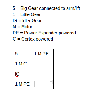

We had something like this, and I fixed the problem by connecting four of the lift motors to the power expander (one motor per port) and the other two running off of the cortex (but not on the same PTC as the drive, ports 1-5 and 6-10 have different PTC’s). Our lift doesn’t use high speed motors, but it is still capable of getting objects in the far zone. We have yet to have problems with it overheating, even after running non-stop for 30+ minutes. Another thing that might help, allow the lift to come back down slowly. Don’t use motor power to make it go down. Also try to avoid allowing the lift to come down too fast, as this can add energy into the motor and can cause it to overheat. How are the gears and motors arranged? This might also be a factor. Ours is set up like in the picture below. The gears to the side of the large gear is spaced so that if there is too much resistance, it will start to slip so that your motors don’t overheat. If you continue to have trouble, please contact me and I will try to help as much as I can.
