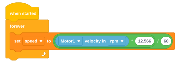

You could always use the RPM sensor that is built-in to the V5 motors. You have to do a little math to convert motor speed (RPM) to inches per second. Assuming you are direct driving the wheel or driving it at a 1:1 ratio, the math should look something like this.
(motor rpm * Circumference of the wheel) / 60
If you’re not directly driving the wheel, replace the motor rpm with your motor rpm * your gear ratio.
Simple block code for 4in wheels
Screenshot 2024-03-13 9.29.27 AM

you would take your weel circumference, multiply that by your gear ratio, your motor speed and the percentage it is spinning at, then divide by 60 (minutes to seconds conversion)
example:
360 rpm chassis (3:5, 600rpm) with 3.25 inch wheels
(.6 * 600 * pi * 3.25 * 100%)/60 → ~61 in/sec
