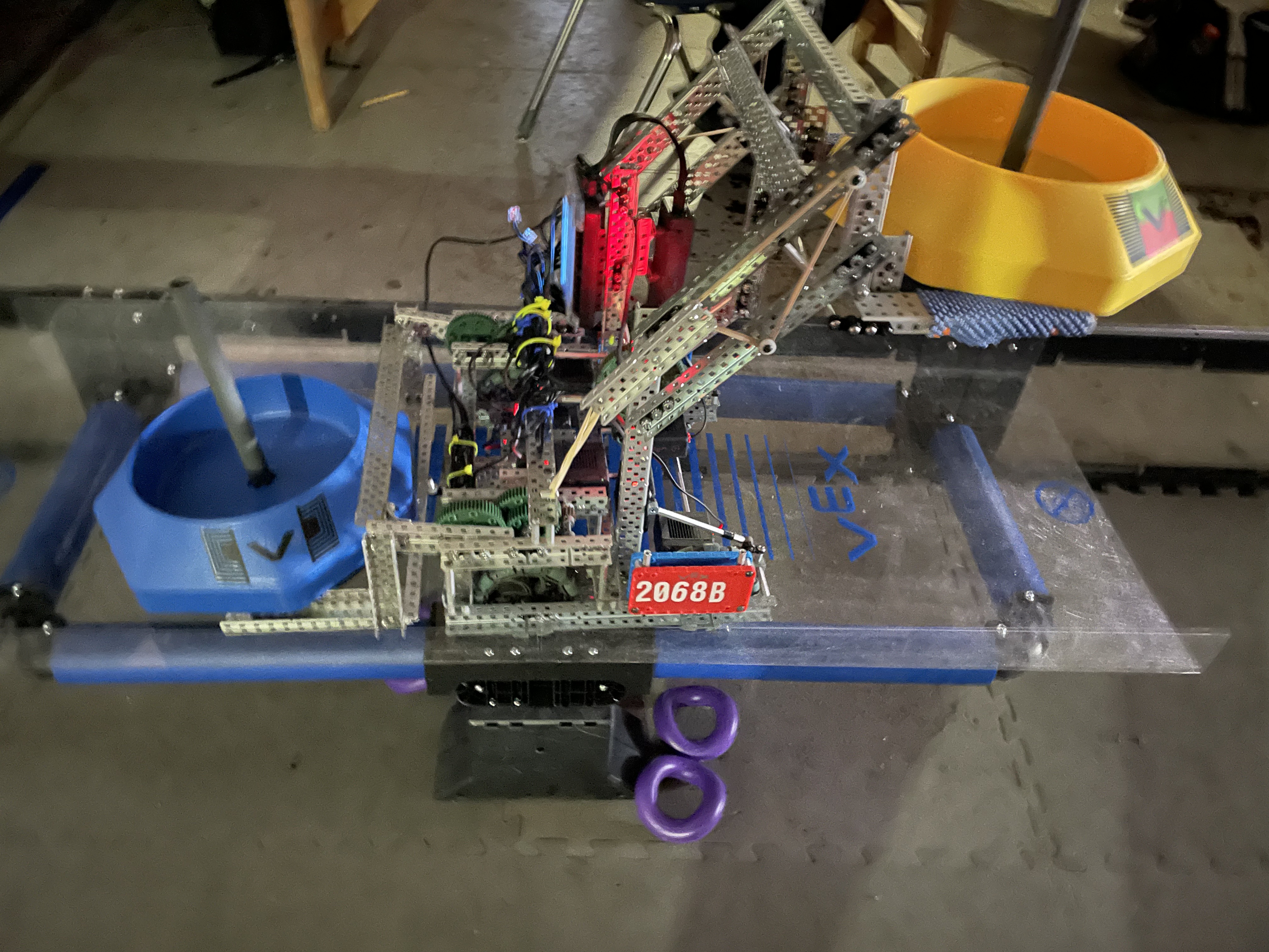

Ok so our lift has a 1 motor 100 rpm lift geared to 1:7 that also banded but the issue is after like 2-3 times when we lift the goals on the platforms it just weakens and it can only lift it half way. Any solutions?

@rathul_2068, can you send pictures of the lift? And make sure that the rubber bands are on the right way, so they help the lift instead of fighting it.
I will send a picture tomorrow since I have robotics that day
Right now this is the only picture of the lift but you can’t tell very wellimage
Maybe I’m wrong but from that picture, it looks a bit like the rubber bands on each side of the 4 bar are different? Is this the case? Is there a reason for this?
lol its cuz its all made of steel
edit: actually tho check if your screw joints are over tightened and feel around the lift when it moves to try to identify where friction could be. I couldn’t tell you from that picture but it is likely a combination of friction and the fact that it appears your 4 moving bars are made of steel. Just looking at your lift I would expect motor burn to happen regularly at around 5-8 minutes of use

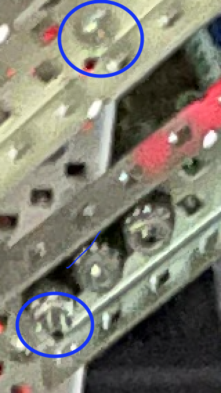

A lift of this size should work well, whatever material it is made out of. Our org only started to buy aluminum parts recently so I have a similar (but larger) 4 bar made out of steel. It is powered by one 100rpm motor geared 1:7.
Try adding Teflon washers so it’s not metal on metal. That can cause a lot of friction
Both things that you circled don’t seem to need teflon washers. The top one looks like a screw and would only need a washer if it was acting as a screw joint(on the flat side of the kepts nut).
The bottom one looks like a end of a screw joint and doesn’t need a washer because there is a bearing flat there.
