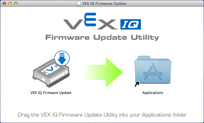

After you download this DMG image to your computer, please open (mount) the DMG image. You will then see a Finder window with this displayed:
To install the VEX IQ Firmware Update Utility to your Mac, simply drag-and-drop the VEX IQ Firmwate Update Utility icon in this Finder window onto the Application folder shortcut also in this Finder window. Once that is complete, close out of the Finder DMG window and unmount the DMG image by dragging the DMG image onto the Trash can icon in the Dock.
