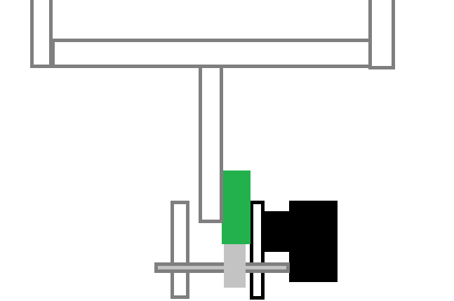

Hello VEX community! My team and I have recently created a 4-bar lift that we have yet to attach motors to. As of now, we have six motors on our robot, and the limit is eight. We only have one to allot to the lift driver, and I’m worried that it won’t be able to drive both sides equally. That is to say, I think that the side with the motor on it will be lifted higher than the other side, and it will be lopsided. I’m also thinking about whether or not it’s worth the trouble to add high-strength axles. Thank you all in advance!

In The Zone (2017-18) robots frequently had arms that were actuated by one central motor. Set up the motor and gearing in a central assembly with one arm that protrudes. Then T off of that arm to link to your 4-bar.
Crude photo below.
This is bad building practice. The lift should be rigid (no flexing) even without any rubber bands.
Not preferably, required
If the load on your 4 bar is low then you can get away with it just fine. That being said, if you’re lifting a mogo you’ll definitely need bracing
