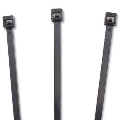

Who needs motor screws? We’ve used two of the larger VEX zipties to hold our motors on for the last two seasons. We take out all of the casing screws too.
Blue is good, but the purple is made for small screws with vibrations. We have used blue for years and have had no problems until somebody just glops on a huge amount. Then you will have to cut it out or come up with new and innovative ways to get it out.
@Jobe - just tried that and it’s stupid effective… gonna need a 1000 zip tie bag…
https://www.uline.com/Product/Detail/S-12396/Cable-Ties-and-Tools/Black-UV-Stabilized-Nylon-Cable-Ties-11-40-lb
Edit: Tried it. Face palmed.
