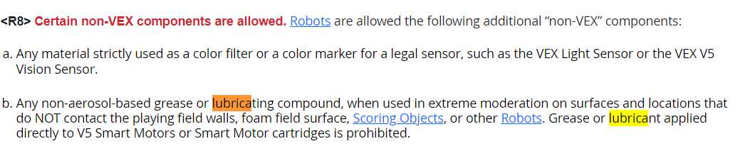

WD-40 not for the win bro. If you use lubricant in the motor that is illegal (unless your referring to the gears) along with the freeze spray because it is an aerosol product.

Correct me if I am wrong, but doesn’t White Lithium Grease fall in the grease category, being prohibited in <R8.b>?
<R8.b> “Grease or lubricant applied directly to V5 Smart Motors or Smart Motor cartridges is prohibited”

Yea and no. Aslomg as the grease is applied to gears not he motor or motor cartridge it is legal
