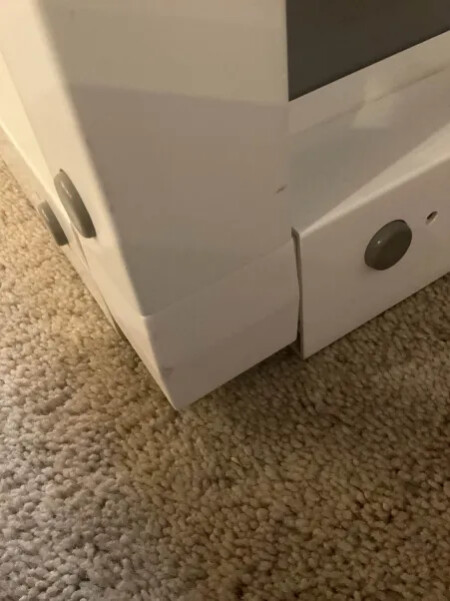

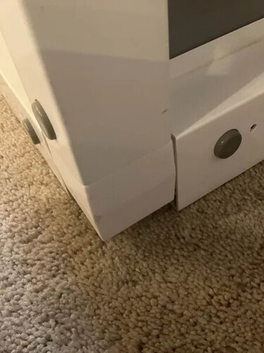

i think it could be static but I dont know much about static, but we have our field on this carpet and we also have antistatic tiles, so will there still be static buildup
