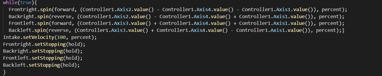

Our motors go up to about 50 rpm when we run them using our code, but when I run it off the brain through devices, I can go up to 200. I understand going super high puts quite a bit of stress on the motors, but I would still like to try to get up to 100. Does anyone know how?
Post your code. ​​​​​​​​​​​​​​​​​​​​​
Nothing so far I just have the drivetrain and tried setting the Intakes velocity to 100 though I kind of knew that would not work.

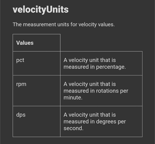

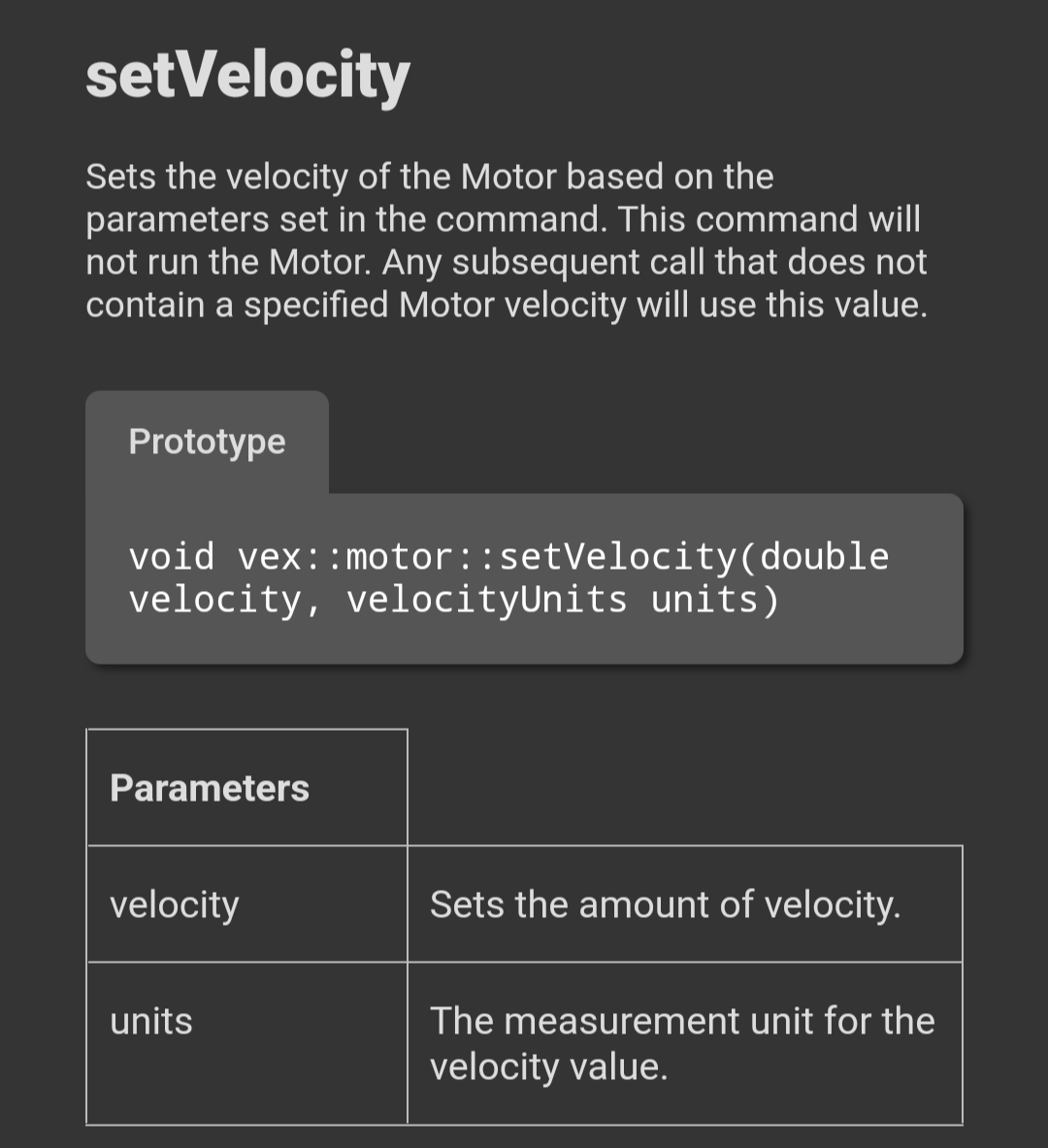

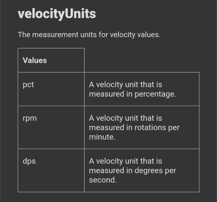

The function you are using asks for velocity units. You are giving it percent units. It is probably taking this as a command to spin at 100 RPM, not 100%.

What are you using to control the intake? Something like this would work:
if (Controller.ButtonR2.pressing()) {
IntakeMotor.spin(directionType::fwd,100, percentUnits::pct);
else if (Controller.ButtonR1.pressing()){
IntakeMotor.spin(directionType::rev,100, percentUnits::pct);
else {
IntakeMotor.stop(brakeType::hold);
