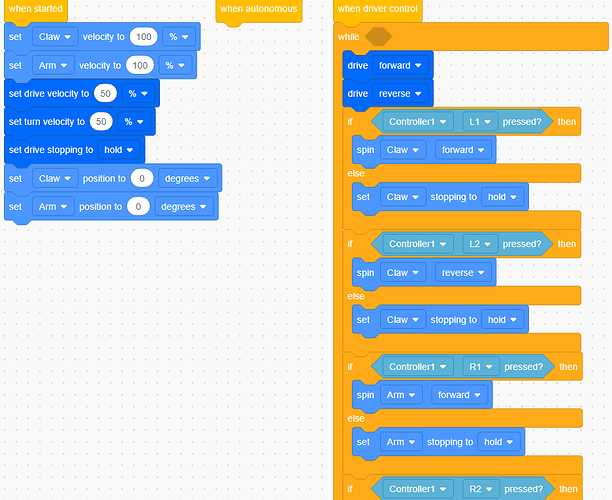

I’m using V5 smart motors and VEX code blocks to program. But my motors are not holding correctly. When we control the arm to move up it falls down if the correct button is not pressed. How do I get my arm and claw to hold without holding the buttons down?

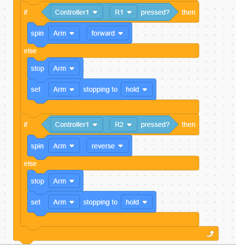

set Claw stopping to hold doesn’t actually stop the motor. You need to actually stop the motor for it to work. There should be something like stop motor hold
Is this what you are referring to? code
Yes. Try using if controller R1 pressed then the next part is else if controller R2 pressed then else motors stop

Looking at the blocks you could put an if statement in the else of the first one, and it should function like you want

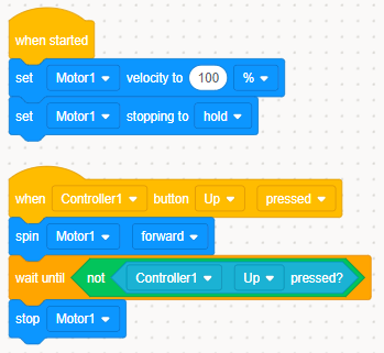

You don’t even need to use a forever loop. This will do it for one motor and button. Just add the different buttons and motors you need.
You do not need to use a holding power with V5. That was with the older platform.
