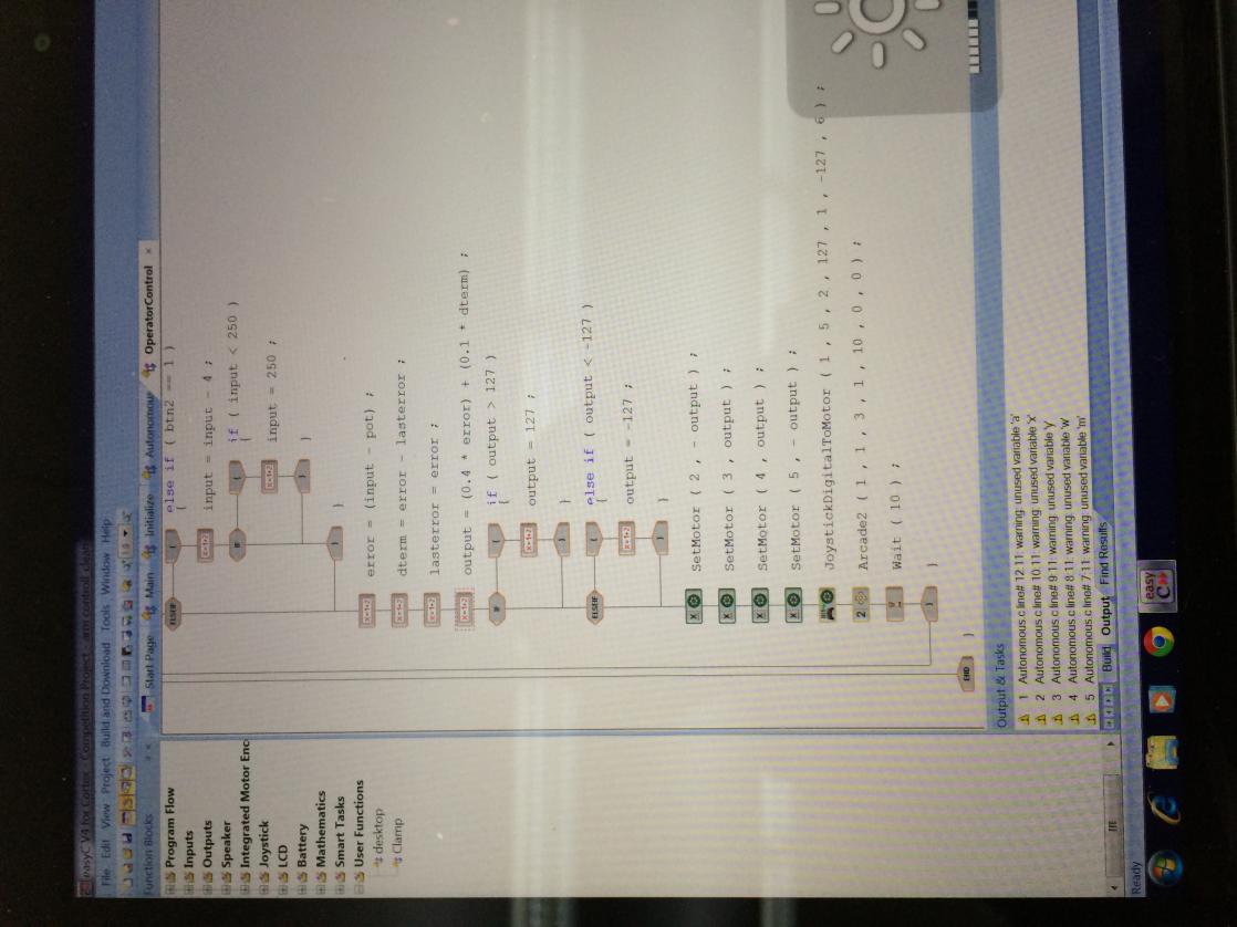

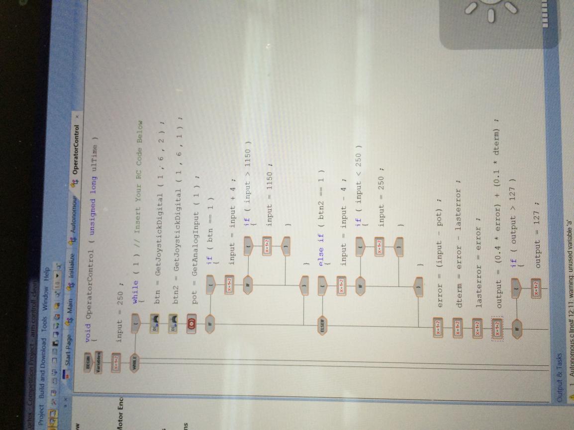

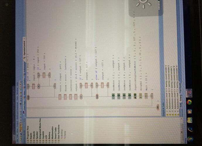

Hey guys, so our teams been having a bit of trouble with our lift now working. Initially the lift was just shutting down for no reason, but then I realized that the slow red blinking light was displayed on the cortex beside “Robot”. I found out that was a microprocessor issue so because I’ve got a PD controller running on it I figured maybe there was just to much it had to plough through. So I stripped it down to a bare bones controller (no comments). How ever the lift is shutting down at odd times. For instance. We’ll be running it and it works perfectly. Then we’ll turn it off then on and it won’t work, repeat that and then on like the 3 try it’ll work again perfectly. I think it may be the motors over heating but it doesn’t make sense how it will run then stop then after I turn it off/on 1-3 times it’ll start working perfectly again. The code is in the attachments.

Sorry about that I just took photos on my phone because the internet at our school isn’t compatible with windows OS. Before I stripped the program the whole robot basically was shutting down (no squeal). Once stripped though the motors are squealing when not working and barley move. Here is the proper code. Yes all the batteries we use are fully charged. However I have never seen that flow chart before. Our lift is currently on the 1-5 breaker so I’ll try distributing them. Also we’ve checked for friction and we have just enough elastics to to hold up the lift and not raise on its own.

Without testing it, I think your code seems generally fine. However, there might be some issue in the calculations. When you run the robot, see if the output variable value or motor powers are what they should be. I don’t know easyC well, is there a debug stream or a live view of variables and motor powers?
Just to see if I’m understanding correctly, the value that input is being set to is supposed to be the pot value you want the lift to go to?
Make a really simple program (probably what you already tried) that is only setting the motor power to the joystick value, and see what happens.
