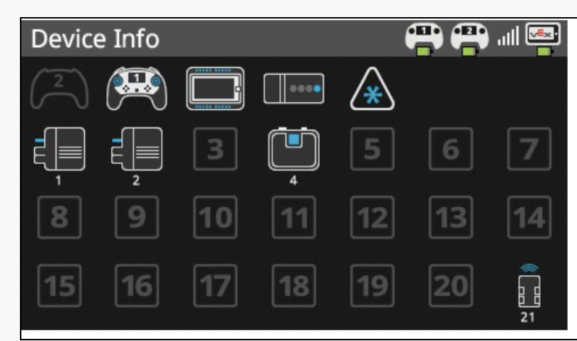

I have had this problem happen to me three times now on the same robot where the motor will just stop working. I know that this is not a coding issue. Does anyone know why this is happening or how I can fix it?

is the light on the motor port still on when it’s plugged in?
Is the motor blinking when plugged in ?
Is it making a noise when being run?
Check to see if you can find the motor in the brain screen.
No the light is not on.
It is not blinking but is making a small noise when its plugged in running and not running.
I do not see the motors in the brain screen.
is it like a high pitched quiet whining noise?
This usually indicates that the motor is dead.
Yes

I did this and replaced the bad motors. I’ve been driving the robot and nothing has happened yet! So I’m guessing it was a bad port on the brain that somehow destroyed the motors after a while of them being used. Thank you for your help!
