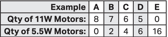

So Motors, i am confused, What is the difference between 11W and 5.5W motors? and then there are discontinued motors. So my team only has 11W motors, should we buy 5.5W? and what is the benefit to having 5.5W motors?
Vex has an 88-watt motor limit for v5. It used to be 8 motors, but since 5.5W motors were introduced, they changed it. This means that if you wanted, you could have sixteen motors, (if they were 5.5W.)
R12: Motors are limited. Robots may use any combination of VEX V5 Smart Motors (11W) (276-
4840) and EXP Smart Motors (5.5W) (276-4842), within the following criteria:
a. The combined power of all motors (11W & 5.5W) must not exceed 88W.
b. V5 Smart Motors, and EXP Smart Motors connected to Smart Ports, are the only motors that
may be used with a V5 Robot Brain. The 3-wire ports may not be used to control motors of
any kind.
Examples of legal motor combinations:
Screenshot 2024-01-19 at 1.05.04 PM
11 watt motors have more power than 5.5 watt motors (watts is a measure of power). You get to adjust speed or torque through your gear ratios (or gear cartridges).
