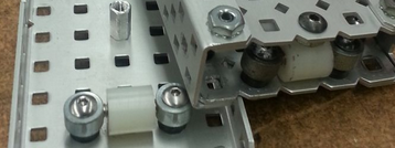

We used a multi stage lift for Gateway, here’s a photo (partially disassembled).
and the original concept CAD.
It worked well but was ultimately too slow for the game, it used the older style linear slides.
