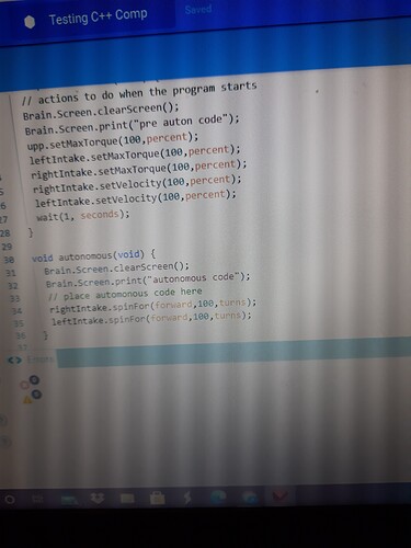

So I’m attempting to use Vexcode V5. I can either type the code out in C++ or the blocks. In either case I can not figure out how to have both intake motors spin at the same time in autonomous. Can anyone help me out?
What does your current code look like? Its easier to find the issue if you post your code
The laptop isn’t on wifi or id just curious c and v it in.
For the first spin intake, put a comma next to turns and write false.
rightIntake.spinFor(forward,100,turn,false);

Yeah. You need to place the false there for the “wait for completion property”
The entire code segment should read:
rightIntake.spinFor(forward,100,turns,false);
leftIntake.spinFor(forward,100,turns);
This essentially “queues up” both actions and executes them simultaneously. For the first command (rightIntake) we do not wait for completion so it goes onto the net line while the right intake has just started spinning. The left intake works as normal.

Seems to work. Thanks for the help.
