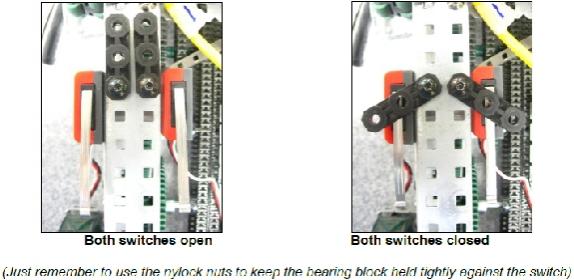

I absolutely hate using jumpers in and out of ports on the robot controller as a means of selecting an autonomous routine. Take a look at the document I uploaded to the Vex Code area on the topic of multi-autonomous. If you use limit switches with a bearing block, it becomes a simple dial to select on/off. They have the added advantages of:
[INDENT]Being mounted so they are accessible to the drivers,
Can be labeled so that the switch positions and routines are quickly identifiable
There’s no accidental plugging or unplugging of jumpers in the wrong port on the robot controller
[/INDENT]See the attached photo.
If you are using more than 4 routines then a potentiometer is definately the way to go even if you are not running short of I/O ports. A pot gives you a single dial to select multiple routines and only uses a single port. I have successfully used a pot to select up to 10 routines.
