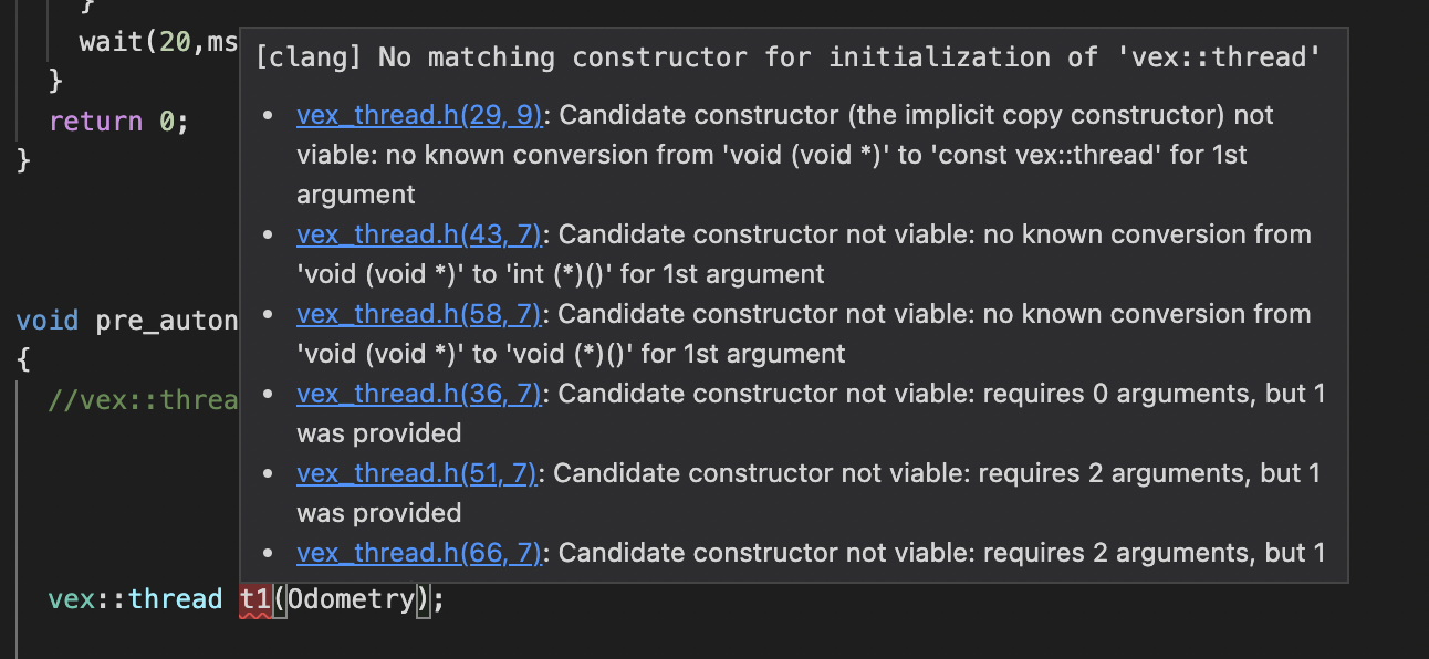

Multitasking 2 Variables
I have 2 variables that I use and I want to know how to make them both run at the same time when a button is pressed. How would I do that with the code I have?

I basically want for an example BScroll and RedScroll running at the same time with a minor delay with each one.

Variables don’t run. If you jump to a variable, you’re running the stack as code, and thats probably not a great idea.
yes but can I have those running at the same time?(I’m sorry if I’m appearing as rude. It’s just I’ve been looking for an answer for like 3 hrs)
Let me clear up what I mean to do. Let me use the variables BScroll and BlueScroll as an example.
I want when BlueScroll starts to run it’s code, BScroll’s code to start running at the same time. How will I do that?
You don’t want variables to run, you want functions to execute concurrently. You can pass a function (that takes no arguments) as an argument for creating a task. The Brain will run the two tasks under the illusion they are running at the same time.

I have a question. Do you need to use pointer to call a void function for thread? This is my code. vex::thread t1(void *Odometry); I’m not sure if this is correct.
You don’t NEED to, at least I don’t think (looking at jpearmans code) but tbh if you’re worried you can just make it an integer and have a pointer to that. It’s still gonna execute so
I tried his code. It doesn’t seem right.
Odometry is a void function. Is it ok to put it in the thread? Or do I need to use int function?
Why not try it first? It’s not difficult to change, you just need to change the type and add a return value (just do 2 as the value)
Plus it does say that void pointer is inconvertible to int pointer so I’m thinking I’m correct.
This is a two year old topic, you should probably have started a new one.
What exactly are you trying to do, what does the Odometry function look like ?
I am trying to use thread to do multitasking.
void Odometry(){
 while(Competition.isAutonomous()){
    double encdChangeL = encdL - prevEncdL;
    double encdChangeR = encdR - prevEncdR;
     double sumEncdChange = encdChangeL + encdChangeR;
deltaAngle = (encdChangeL - encdChangeR) / baseWidth;
double encdChangeS = encdS - prevEncdS;
shiftS = encdChangeS;
angle += deltaAngle;
double halfSumEncdChange = sumEncdChange / 2;
if(deltaAngle==0)
  position = position + Node(halfSumEncdChange * sin(angle), halfSumEncdChange * cos(angle));
else if(deltaAngle!=0)
  shiftS = (encdChangeS/deltaAngle) * sin(deltaAngle/2)*2;
double xShift = shiftS * cos(prevAngle+ (deltaAngle/2));
double yShift = shiftS * -sin(prevAngle + (deltaAngle/2));
position = position + Node(position.getX()+xShift, position.getY()+yShift);
prevEncdL = encdL;
prevEncdR = encdR;
prevEncdS = encdS;
wait(5,msec);
ok, so at the point you try and start the thread in pre_auton, has Odometry already be defined ? ie. is the Odometry function in the same file and either declared or defined before pre_auto ?
